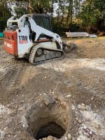

Next up was getting the post holes dug and signed off on by the inspector:
I had a crew do the assembly on the pole barn kit. They worked quick and the initial structure was up in a couple days:

2 weeks ago I took some time to layout a small pad for the man door and also one on the back side for a compressor 'hut'. I still have yet to pour concrete, but it will get done in the next couple weeks
Lastly, I finally took on the task of blowing in ceiling insulation. First machine I brought home from Home Depot was a dud and had to go back for a replacement. Otherwise, this stuff is super easy to install. The 1200 sq ft (scissor truss) ceiling took ~30 bags. At qty 30 you get a bulk discount and save over 25% FYI... $850 for ~R50 with a little less towards the sides due to the smaller distance between ceiling and the roof panel with the scissor trusses. Not a fun job, but I'm glad it's done. I removed 2 side panels from the barn to gain access to the attic.
