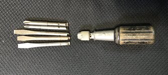

I was over the moon to find this roll-up at the flea market this morning. I am fairly positive it's a No. T-52 SPINTITE set, which W-W called a Deluxe Electrical, Ignition, and Radio Set.
It's fairly complete. Includes the #3801 Universal Handle, seven (7) nutdriver bits (#3806, 38078, 3610, 3611, 3612, and 3614), and what they call an insulated Neutralizing and Alignment Combination Screwdriver Wrench, which is that black two-part tubular piece. It's missing three screwdriver bits (#3803, #3804, and #3805), a Reamawl bit (#3802), the Longnose Pliers (#1781 ), and the Diagonals (#4601).
31,049
The roll-up will need some surgery, and the marking is not strong, but legible. Here're also some close-ups of that tubular piece.

Fantastic, Don. I need the three screwdrivers and the Reamawl! I think I am holding a few things for you but I can't remember what they are! :)
What do you know about the pliers? I have to admit, I don't recall ever seeing W-W branded pliers.
31,049
Right. And you're the biggest W-W collector I know. Me either. So please sanity check my thinking here, because I don't want to be accused of cutting inconvenient corners.
I looked through hundreds of period general hardware store type catalog cuts in BK's zip file, and I looked through the 1923, 1941, and 1954 catalogs.
Their earliest detachable SPINTITE sets (20's-30's), did not even come with pliers.
They never offered any pliers, not even in their "Other" "Sundries" "Accessories" back pages. They did offer other tools in that category (i.e., screwdrivers, adjustable wrenches, etc), separately, none of which they were known for making in-house. Meaning, other than the dykes and long nose pliers that came in this set - the name of which they had shortened to the simpler "Repairman's Set" by 1954, I can find no record of them offering those or any other pliers whatsoever.
My conclusion, therefore, is that they were clearly 3rd party, and I don't think it's a stretch to suspect they may not have even been branded Walden-Worcester.
The 1954 catalog offers a better view of them, by the way.
Looking kinda Utica to me, but I'm interested in hearing other opinions.

Don, those two long, thin drivers with different plating are also used in the '20s hex drive set, and if Lugz doesn't need them, they are on my search list, and I would be very interested in them.
31,049
...those two long, thin drivers with different plating are also used in the '20s hex drive set, and if Lugz doesn't need them, they are on my search list, and I would be very interested in them.
That's cadmium and the markings look wartime to me, Beemer. Where did you post your set? Are the other pieces cad-plated? Here's the thing. I DO need all three screwdriver bits, including those two. My set is not cad-plated and those two will look odd next to my other pieces, but not too odd, since I suspect mine is either prewar or immediate postwar. But I would rather have them looking a little odd in my set than yours. :) As I am sure you'd understand. That is, unless your set is cad-plated. If that were the case, I would, in the spirit of collecting brotherhood, give up those two to you and keep looking.
