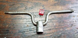

I could've sworn I saw another one of these rim tools here on GJ somewhere, but a search on this thread, the other Walden thread, and the forum turned up zilch. It has two brandings and two part numbers: "WALDEN-WORCESTER 1960" and "WHEEL TOOL CORP 60534". I'm thinking Walden is the OEM and the Wheel Tool Corporation is the end item customer. A quick search on Wheel Tool Corp yielded nothing, but I'll try harder later. The tee-handle - which is fixed, it does not swivel - has a pry blade on one end. The hex is 3/4".
