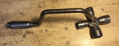

Pick up this 4-way socket wrench
Model 1452 Walden Worcester
Sockets are not size marked but AA says they are 5/8,11/16,3/4 & 7/8”
Patent date oct. 22, 1918
29,377
Very interesting find.
The patent number is 1282028 issued Oct. 22 1918 to Warren S. Bellows, who was running things at Walden Worcester at that time. The patent actually applies to the manner in which the sockets are attached to the shaft, not the design of that particular unit.
(see https://datamp.org/patents/displayPatent.php?number=1282028&typeCode=0 )
The earliest catalog listings I have for the model 1452 Walden Worcester Four Way Rim Wrench are in the 1927 Belknap and 1927 Wyeth hardware catalogs.
Both catalogs show the unit as having 5/8", 11/16", 3/4", and 7/8" socket openings. The Wyeth catalog notes that "individual sockets may be replaced."
Walden Worcester 1452 Four Way Socket Rim Wrench 1927 Belknap Hardware & Mfg. Co. catalog pp 271.jpg Walden Worcester 1452 Four Way Socket Rim Wrench 1927 Wyeth Hardware & Mfg. Co. catalog pp 1914.jpg
I have nothing showing the model 1452 after 1927.
The 1927 Honeyman catalog shows a model 1453 Four Way Rim Wrench, having the same size socket openings, but this model has a "steel grip in center", presumably freely rotating on the shaft if I am interpreting the illustration correctly.
Walden Worcester 1453 Four Way Rim Wrench 1927 Honeyman Hardware catalog pp 450.jpg
The 1929 Farwell Ozmun Kirk & Co. catalog shows the model 1453, and notes that "individual sockets can easily be replaced".
Walden Worcester 1453 Four Way Rim Wrench 1929 Farwell Ozmum Kirk & Co. catalog pp 3561.jpg
The 1932 and 1935 Farwell Ozmun Kirk & Co. catalogs both list the model 1453, giving it much less page space than in the 1929 issue.
Of note is the wholesale price of the unit dropping $1.00 between 1932 and 1935. If I were a betting man, I'd wager that by 1935 the handwriting was on the wall for the "Four Way Rim Wrench". Marketing managers probably figured out it was going the way of the wagon wheel. Perhaps it had something to do with the weight of the unit more than doubling over the course of 8 years.
Walden Worcester 1453 Four Way Rim Wrench 1932 Farwell Ozmun Kirk & Co. catalog pp 3579.jpg Walden Worcester 1453 Four Way Rim Wrench 1935 Farwell Ozmun Kirk & Co. catalog pp 3608.jpg
This post would not be complete without a contemporaneous image of repairs from the same era being effected. This one seemed appropriate, even if it doesn't appear to involve changing wheels:
Based on only the scant catalog coverage that I have, I'd posit that your most recent acquisition was made no later than 1927. Of course, that's just wild speculation on my part.
As an aside: the 1929 Shapleigh Hardware Co. catalog shows similar models manufactured by "Copperhead" (model 4100) and "Blackhawk" (model 5104), both having the same size sockets as the Walden Worcester models 1452 and 1453.

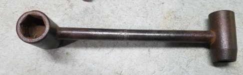

Yesterday, I came across an early wrench of the type made popular by Walden Worcester, however, it is not marked Walden. It is marked "Stevens New York. The round shank connects two back-to-back sockets, giving the wrench four openings, which measure 1/2, 19/32, 5/8, and 11/16. This is unusual for Walden designs, but they did list one with larger openings.
It is known that Stevens Company bought out (merged with) Walden in 1926. Prior to that, Stevens, under the "Speed-Up" trademark, sold a great variety of specialty tools for maintaining and repairing Ford Model T cars and TT trucks. The Stevens logo was an S in a triangle, surrounded by an outer ring containing the words "Stevens New York". The trademark showed the words "Speed-Up" being emitted from this logo.
The Stevens Speed-Up catalog T-106 (available on Internet Archive), dated 1923, contains "Spintite" nutdrivers, apparently obtained from Walden. It is possible (and due to the later takeover, likely) that Stevens obtained a certain access to Walden products during the 1920-21 bankruptcy proceedings.
The T-106 catalog also lists a four-way wrench (T-460) of similar design on catalog page 13. This wrench is slightly different in that the outer surfaces of the sockets are hexagon, perhaps stamped steel, like early Mossberg sockets. No opening sizes are listed, but it brags of fitting the common bolts on Model T Fords.
My wrench has what appears to be Walden-design forged sockets. I did find a later Stevens-Walden catalog on Ebay that shows a wrench (T-460) like mine for Model A Fords, which would make it no earlier than 1928, and since there are no listing for V8 tools, probably earlier than 1932. It is listed under "Walden-Worcester Wrenches." It lists the openings as 1/2, 9/16, 5/8, and 11/16.
My wrench is probably the same as the Ebay listing, and the 9/16 opening is either stretched out or was made sloppy.
The interesting thing about this wrench is the markings. There is a box outline that contains the logo, which is a tall S bracketing the "TEVEN" and "NEW YORK" lettering on each side.
The photos show the tale:
