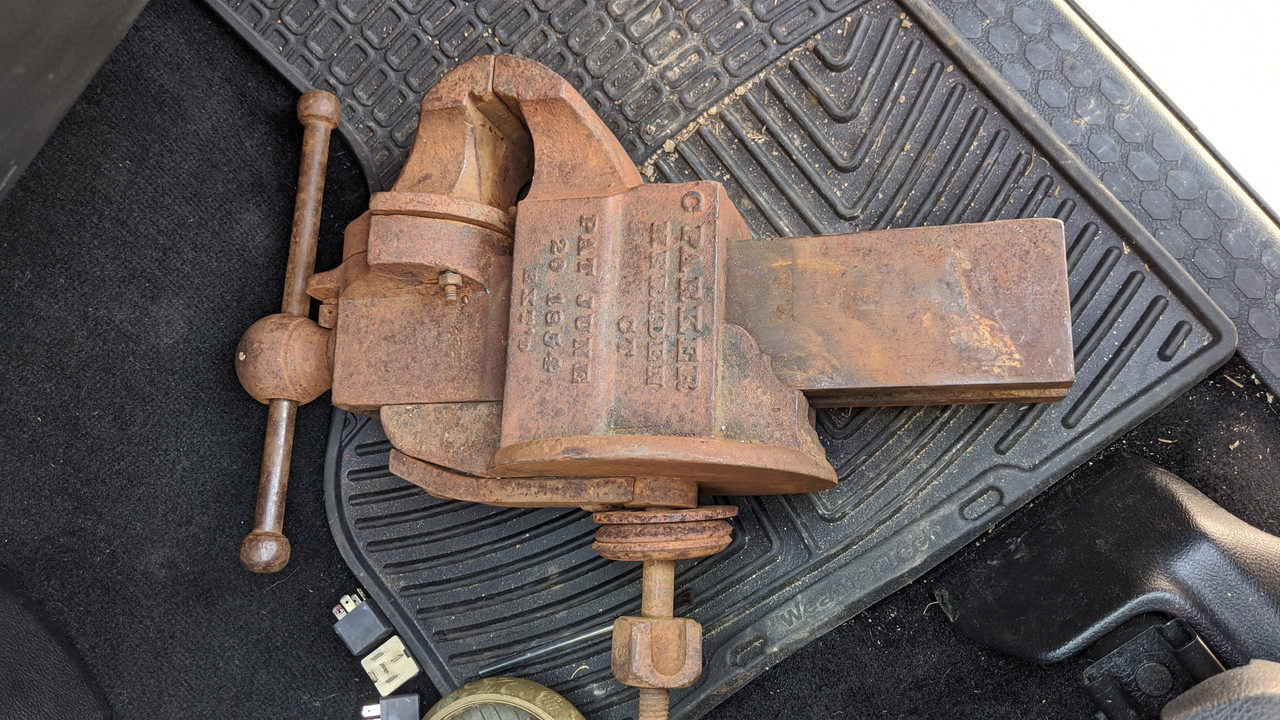

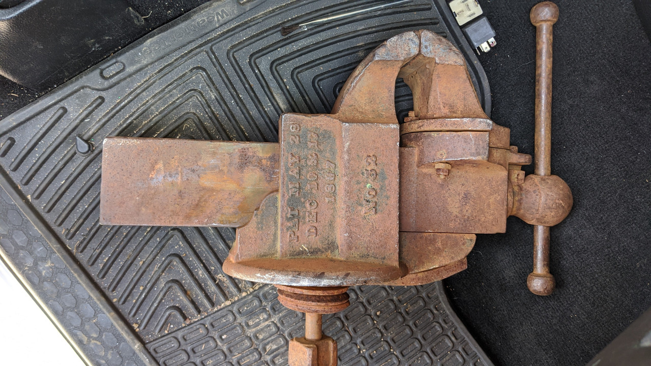

Hi all, new guy to this forum. I just picked up a Charles Parker Vise No. 1!!!! Don't know the significance (of No. 1) but haven't been able to search/find anything similar. It weighs about 41 pounds, 3-1/2 inch jaws, missing the screw collar but I see I can have one made at benchvisejaws.com. The jaws appear to be in good condition, no signs of abuse.
On one side embossed letters read "C. PARKER, MERIDEN CONN., PAT JUNE 20 1854. EXT'D."
Other side reads "PAT.MAY.23, NOV.26., DEC.17.1867, No.1."
In incredible condition and fully functional!!!! The lead screw was black with grease but on cleaning reveals really cool lathe/machining marks. I was able to remove the pin and the static nut which were well preserved by over a hundred years of grease and grime.
I've been dismantling and cleaning the vise up carefully and have tons of pics but don't think I can post yet as I'm a FNG, but I will try. Some forums require several posts before you can upload pics, not sure about this one. I really want you guys to see this.
Since I learned most of what I know about C. Parker vises from all your threads and posts, I figured I'd join and hopefully get some feedback from the crew.
Looking forward to some feedback/opinions/thoughts/expertise. Will post pics ASAP.

Thanks Zoom. Do you think that if it has the 6-20-1854 but not any of the 1867 patent dates, then perhaps manufactured between those dates? On the No. 172 with 4 dates, one patent is for a swivel base attachment (Dec 10 1867) which makes me think showing patents were prestige and advertising. But then, why would they not list the 1854 patent on the No. 172. I don't know.
One would need to check that 1854 patent for details, but it's possible Parker weren't actually using the invention claimed in that specific patent on the later vises.
Another option (although probably less likely) is that the vise was made after 1871 and the expiration of the seventeen-year life of the original patent.

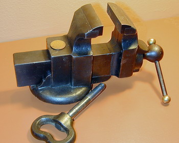

I've got this ole gal:
Not sure of her date of birth, but I'd have to guess, 1860-1870s.
I haven't seen many vises with a pivot front jaw. Could you share a couple more photos? Is it a no. 52 or 32? Also what holds the front jaw stationary?

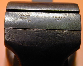

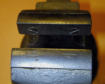

Hi Fierljeppen
Very nice Parker! I don't see many Parker's without raised lettering. Is there raised lettering on the one side? Could you check the top of the front jaw for stamped lettering? Perhaps a little oil and 0000 steel wool will bring it out. That's an oldie.
Fierljeppen
Jan 26, 2018
1,159
bubinga2...The vise is completely unmarked, just like the -5- others I've seen just like it. I've seen some with brass balls on the spindle handle and at least -1- with Parker stamped on the jaws.
The jaw width is 3-5/8" just like a Parker no.1 should be. It's the oldest Parker style vise that I know of, but I'm hoping your thread will bring us some more styles from this era.

Mine has brass balls and stamped on the front jaw. The jaws are 2" wide and there are no raised letters. Here are a couple pics.
