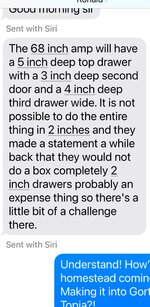

All this talk about custom Epic boxes got me curious about the current details. I’m out of the loop since I retired 6 years ago. Sent a text to my Rock-N-Roll guy (who just retired last month after 25 years with Snap-On) and asked about an all 2” drawer 68” Epic. Here was what he sent me….
So it does seem that there are some restrictions on customization, which does make sense as a 2” drawer is nearly as expensive as a 8” drawer, especially when you add in the 6 more slides to the total.

lugnut71
Feb 14, 2013
1,909
Wyoming
So just to clarify, the single bank 68" epiq comes stock with 5" drawer on top, then a 3" and then 2", not a 4" in third place. Looking at mine i dont believe the sides are stamped to allow drawer slides in the correct position, to swap out the 5 and 3 drawers, however after that you can definitely run 2" drawers all the way to the bottom.
