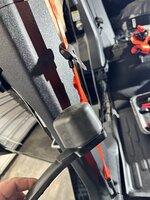

Got some time to put the bronco back together. Should have happened a month ago but life gets in the way!
I was at the dealer last year and saw the code orange Bronco Raptor, had the orange seat belts in it. Decided to buy a full setup from my local ford store.
Started by pulling all the panels off to gain access to the retractors and firing cylinders.
Old belts out and new one installed in the front
I use my snap on bag hammer from the metal shop on all my interior panels - beats hitting it with my fist and doesn’t mar the surface of the trim panels…
Another cool tool is I have a bunch of of these seal tools in various shapes and ends - they come in clutch for quickly getting seals over panels etc. Makes quick work of it, and with the balls on the end of each one they don’t tear anything like a normal pick would.
The rear belt I was able to sneak out with some tight access torx plus on my long aircat air wrench so i didn’t have to take the whole panel off. This is one of those times when you are grateful to have a large tool selection handy!
Also got the new seats in. I hit them with the steamer and the leather heat gun first to get all the wrinkles out and set the leather where I wanted it.
Both front seats in and the rears as well!
Overall I am pretty happy with this build - it is a little more subdued than I usually do for my cars, but at the end of the day that isn’t a bad thing!
All I have left is the front bumper, I pulled the plug on the stereo system for now as that is probably 40-50 hours of work, and there just isn’t time in my life right now for that unfortunately (good problems to have!)

That’s a crazy flaw Tim. Have you checked how elastic it is? I’d also split a bit of it along that line and see if they inside is fiberess (under cured) and not consistently vulcanized

Here is a a crazy one for you. Had a comeback last week. Really sucked as we had to go get the car from Ft Lauderdale and had to not Ony do the job for free but also eat $4g in transport.
Leaking from the cam retainer gasket. Worst possible Spot as it is engine out service.
I have been doing this almost 20+ years and I have never seen anything like this before. Must have been a bad batch of O rings - it is the only thing I can think of.
Now before the internet loses its mind, these are not o rings from Amazon, I but only OEM from Porsche. This is a $14 o ring. Ive seen many o rings failures and 100% of the time it is usually use error. But I have never seen one fail like this and split down the middle.
$14 part cost me nearly 10g. Not super happy about it but it’s part of the game!
98% of you guys are 10x smarter than me, what happened here? Interested in opinions! I have a theory
Age? Maybe just a crusty old stock seal? Guy next to my old shop had tons of NOS parts for 70s and 80s euro cars. Last time I was in there, many had decayed and returned to the earth in the factory packaging.

I agree with 36truck it looks like a manufacturing defect.
Durometer might shed more light, but you need the Porsche drawing/specifications of the ring if you wanted to look closer.
You would need to know how Porsche determines they have produced an o-ring that meets type / design.
I have never seen an o-ring separate like that.
