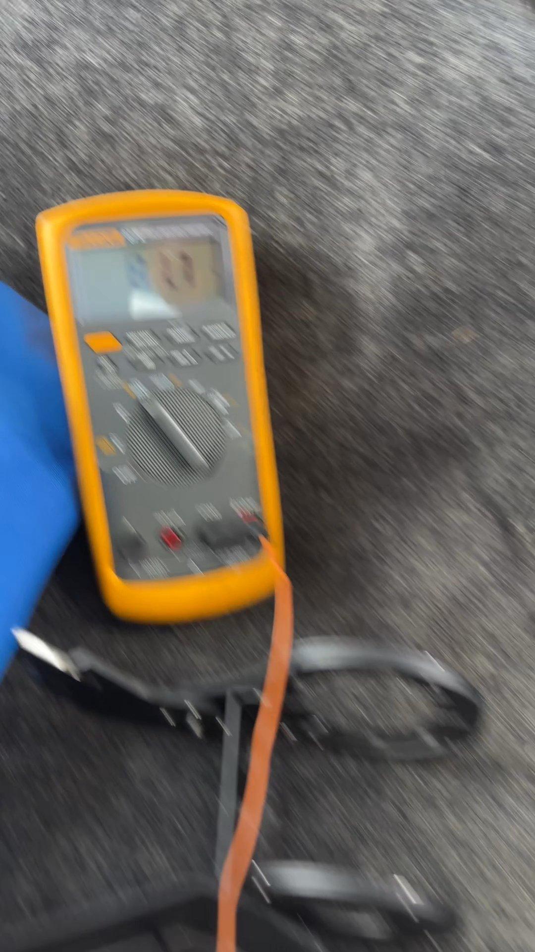

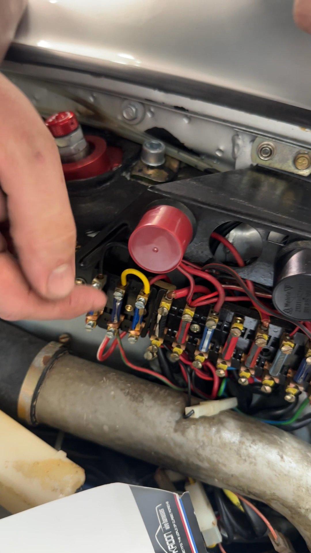

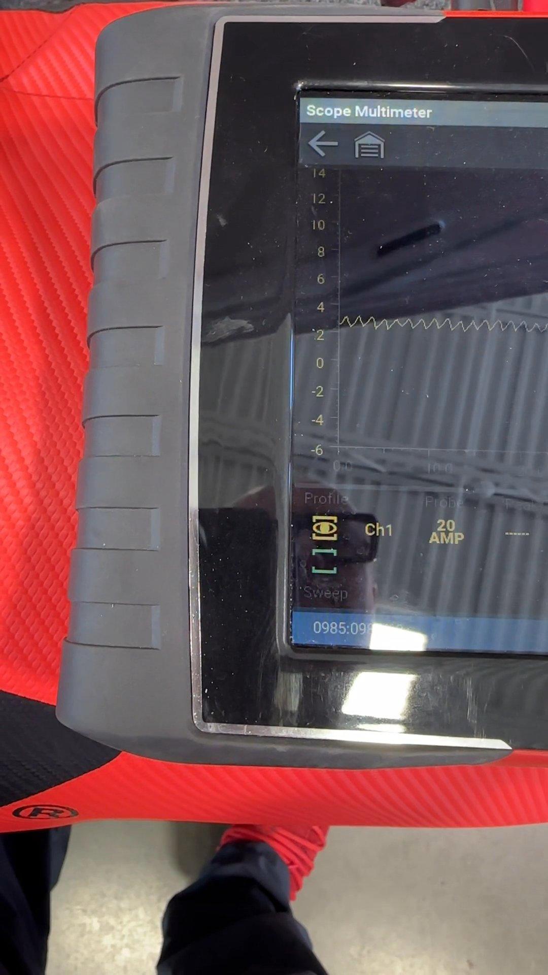

Been a long time since I misdiagnosed something….. Still scratching my head and I am sure you guys all have the answer! Help lol!
Backstory 911 SC comes in, no A/C. Blowers are not working - it has two blowers, one on the evaporator and one on the condenser. All fed by a relay that gets its power from a fuse in the fuse box. Fuse was blown. Ok no biggie right? Slap a fuse and check the wave form on the fuse to make sure there isn’t an issue and send it packing.
No issues here - both fans running and a nice ripple at 3.5amps on a 10 amp fuse. Good to go. Chalk it up to a bad fuse etc - there is the issue of the fuse looked like it had gotten hot - lets have a visual inspection.
Sure enough the green and crustiest - Put a fuse box in it - re do those wires back a foot and retest. No issues and good to go.
Here is a video of the diagnosis and the waveform. Happy customer and problem solved!
NOTTTTTT…… Car comes back a few days later - WTF
O
olsenmotorsports
Apr 13, 2013
764
Chicago, IL
Few days later service comes back hey yo that silver car with no ac is back - check it out please WTF???
Same thing - melted fuse. Unreal. Repeat all the tests no issue - fans work perfect, nice ripple on the waveform - Check the fuse block it is ok (yes of course we mounted it with ceramic isolator paste)
Ok lets voltage drop all the grounds - something is wonky - voltage drop on grounds are perfect - even stud/ring drops show perfect. Voltage drop on all the connectors also pass with flying colors - makes no sense.
No data shows that we need any parts, and we have a strict policy against the parts cannon without data to verify its bad - so lets just eliminate that circuit on the fuse box and run dedicated fused power to the relays and recommend a harness to the customer.
No idea what I did wrong here to mis diagnose this one but I got it wrong and in a big way lol.
here is the final synopsis
I humbly consider myself and my team in the top echelon at our craft and diagnostic ability but sometimes you just freaking get it wrong. Wasted an hour on a diag that was bad.
What should I have done differently?
