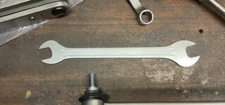

The requirement for thin wrenches is quite a common one, certainly for me. I’m quite surprised that so few manufacturers offer these.
I know nothing about Duratech, but just looking at the image you posted, their own advertising shows the wrench tapering in thickness, with really rounded tips. That really isn’t what you want, and suggests the wrench has either been tumbled, or crudely hand finished. IMG_1775.jpeg
The fact that they are happy to show that image, also suggests they don’t really know what they are doing.
Thin wrenches sometimes work out a bit more costly as they often have an extra stage in the manufacturing process.
These older Facom, for example, were given a pass on the surface grinder to ensure they were perfectly flat, and consistent.
The modern Facom, although not quite as nicely finished, still seem to be just as consistent.
From what I’ve seen, the Capri appear to be essentially the same wrench as the Facom. If the quality control is comparable, and they are equally flat, then they would appear to be an excellent deal!

You must remember no matter what brand these are very low torque tools
Sure, but when you need ‘em, you need ‘em.
Nothing else would fit to steady these ball joints, either for removal or re fitting. As it turns out, the required torque for these isn’t usually that high.
These KTC “Pro fit” are exceptionally nice.

From your picture it looks like you are dealing with a sway bar connector? If that’s the case you should be able to grab the back side of the ball joint with a standard wrench. There’s usually two flats on the back side a open end wrench will fit on. If it was me I would look through my pile of cheap wrenches and grind one down to fit. I keep a pile of cheap wrenches around for this purpose. I have a pile of ground down wrenches I’ve accumulated over the years.
We call ‘em drop links in the U.K, but yes.
In this case there’s nothing on the back side of the ball joints to grab. The only thing you can grab it by are the flats on the otherwise round part, adjoining the thread.
You can’t use a regular open end - the space is too narrow so it just won’t fit the assembled part.

The 440 is a combination wrench. It’s the modernised version of the No.40 combination wrench, but the open end is standard thickness.
The double open end is the No.44. I really like these, but again, they are standard thickness.IMG_1782.jpeg
The thin wrench is the No.31, as shown in my post above.
