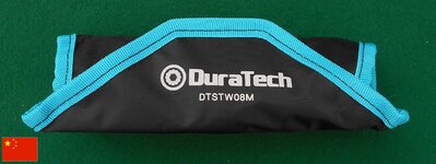

DuraTech DTSTWO8M 8 pc metric thin open end wrench set 06/24/25
Nicely finished.. Looks like nice plating. Pouch is well-designed.
Thickness varies only slightly between the smallest and largest sizes.
For $20 they it'll be nice to have them if/when I do need them.
For what these are currently selling for on Amazon, this one is a no-brainer.

Walmart sells what appears to be the metric Duratech set rebranded as HyperTough. Currently $18.44.
An in-store option for someone that needs them immediately.
29,599
^ I gave that set of "DuraTech" open-ends to my buddy last night when he came over to work on the truck. He took a look at them and seemed pretty pleased.
I told him "Now we don't have to drag out the bench grinder and sacrifice any more open-ends."
I just sent an inquiry to Mr. Tang at Zhejiang Yiyang Tool Mfg. Co. Ltd asking if they're the OEM on those "HyperTough" models. They do indeed look awfully similar (other than the pouch.) Hopefully I'll get a reply this time.
