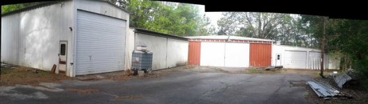

For the inquiring mind, what are the differences in cost between metal and OSB?
In my area I can get painted metal for about $1/sq foot. 7/16 OSB runs about $10 for a 4x8 sheet (about a third).
I've got about 4,000 sq feet to cover and am trying to balance off the costs of painting, ease of handling etc.

The metal and OSB prices were from HD, 12' is $21 ($1.06/sq ft), 16' is $50 (1.04/sq ft). I know Menards is cheaper but it's also about 274 miles from Fulton, Mississippi.
I've also got about another 1,000 sq ft of walls to cover.

I'd be looking around for local-ish lumber yards or metal shops that roll their own panels then. If you find one, they'll probably do whatever custom lengths you want too, which should mean the best price and least amount of costly waste material. It will also go up faster and look better when finished.
