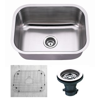

Do you want a undmount? The one you linked to is a drop in. There should be room to mount the clamps.

Yes what I linked is a drop-in. An undermount would be fine. Anything would be fine :) Once I cut out the old sink I'm going to have a hole 21-1/4 by 16. I don't see how I'd get an undermount that fits that cutout into a 23" wide cabinet. Sinks designed for a 24" wide cabinet generally have a 18.5" wide cutout.

How is this going to attach to the underside? Silicone isn't sufficient. The only option I could see would be to drill into the lip and screw it from the underside. Access is really tight along the sides.

Clips
Though I guess you could just screw through it since you plan on replacing it all anyway.

There is no room to attach those pictured clamps. That's the issue. That undermount sink you linked to is 23" wide including the lip.
The cabinet is 23" wide.
There is also only about 3/4" clearance between the sides of the bowl and the edge of the cabinet.
Maybe I'm missing something?

You would have to pull the counter and likely cut the cabinet sides for clearance.
This 22" will fit, but is surprisingly expensive for what it is.

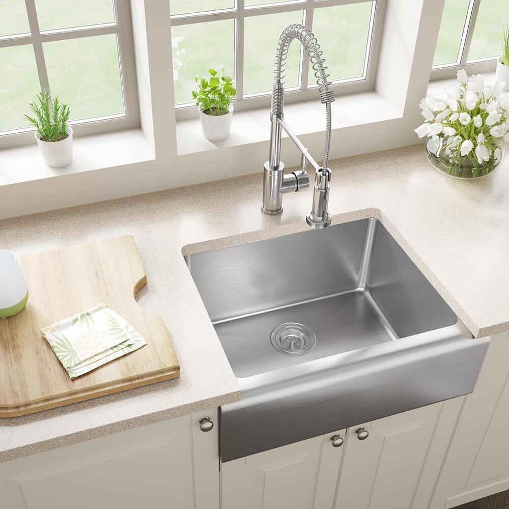

Have you considered a farmhouse sink? Installation requires cutting up the cabinet a bit (can be done with an oscillating multi-tool), but because it rests on the cabinet structure and doesn't hang from the countertop, it isn't a terribly difficult install (the layout is the hardest part, and many come with good templates and instructions), and you don't have to worry about front clearances. Plus you get the biggest basin possible.

What the heck? Wouldn't the drain interfere with that middle piece, or is that drain off-center? Yeah, that's almost as crazy as my bespoke cabinet build. No, a retrofit sink install doesn't have to look like that at all. I wouldn't re-frame the cabinet doors or attach anything to the cabinet back. You need to find one shallow enough that it fits in the space where that fake "drawer" front is and takes its place, where the apron preferably hangs down to cover your cuts but doesn't go so low as to interfere with the existing doors. Usually there's maybe 2" of face-frame wood between the doors and the "drawer" cutout, and you'll have to slice that down.
That depends on the sink, most need scribed to fit. Iirc only the Kohler has a apron that overlaps the faceframe.
They're not the only ones, but yes, they do make one like that, and yes, that's the easy way to go. And I'm not suggesting we search for a difficult option. This example requires scribing the bottom cut (the overhang does make it harder to see your mistakes), but can be made to hide most of the sides:
The Kohler Whitehaven might be perfect (depending on how deep you need it to be), but yeah, that's spendy.
Here's a stainless option (again, I'm not sure if the apron bottom requires a scribed cut, but the sides are mostly covered):
This also covers the side cuts:

My gut is telling me that the drop in (and bodge the rails) is the low-hanging fruit option here.
I have the skills (and tools) to the farmhouse but my wife is getting frustrated with the situation plus we're planning on doing a full remodel in a couple of years. I also have other projects (like finishing the table for my mill) that I'd prefer to spend time on.
The second is only 6.5" deep which is probably going to be an issue. Also 22ga. The plus side is that there is a returned one in good condition on Amazon Warehouse for $49 (list is $83). If it goes pear-shaped that's easy to write off.
I'll probably get the DSE125221. it's 8" deep and 20ga and I want to re-attach the garbage disposal. $166 online though there are a couple open box on eBay for less with best offer which I might make an offer on.
