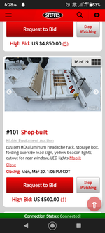

I'm keeping my eyes open for an aluminum semi headache rack that I can cut up and put back there.
Something like this that I can cut up and make fit. Likely have to do make it not aluminum color though. That will be a summer or next winter project. The two square tubes coming up from the bed behind the cab will be the supports for it so all I have to do it fab something up and drop it on. It sounds so easy lol
