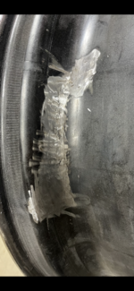

While we were working on other combine things a neighbor stopped in and asked if we knew a rim was cracked on the combine. Well WTF, no !!
Take the tire off so I can grind it out and weld it up.
Drill a hole at the end of each crack to stop them and a few in the middle so I know how deep I’m grinding. The goal is to go deep enough so the weld will burn all the way through.
Not my best work but I put a layer of duct tape on it before putting the tube back in.
Baby powder it like it’s bright red lol
After a few hours of use it still looks great. I hope it holds. A new rim is $2350.

Pops called and said “say hey, I dropped a disc blade off in your shop. We need to put it on tomorrow. I broke one”. WTF okay. 24” adjustable wrench for scale. It’s a 30” blade and weighs 75lbs. Yikes.
This felt like the old Tootsie Pop commercial where the kid is wondering how many licks to get to the center of a Tootsie Pop but instead it was “how many fat guy bounces on an 8’ pipe does it take to either bust the breaker bar or break the 3” nut loose?”
Hello Mr Bearing. You seem to be frozen to that shaft. I destroyed my LARGEST pulley puller trying to get you free. Turns out they don’t preform well with a 24” breaker bar applying the force. I should have seen that coming but I was in my “being polite” phase of attempted disassembly.
I got a little too bully with the air hammer and knicked the bearing seal so I decided to release some pent up aggression and took it all the ways apart. All the ways. Completelyish. Then I got out the hot wrench to persuade it a little more.
Things got heated and I won. Shaft is nice and not damaged. I’m not usually one to brag (yeah okay 😂) but that takes some skill. Skill I didn’t know I had but I assure you I’ll be bringing it up in my next performance review to leverage a big fat raise. “Say boss man, remember when I didn’t destroy that shaft on the disc that one time!?” “Oh you must mean the time you destroyed a $150 bearing because you got bully with a puller and then more bully with an air hammer?” “ Uh, that was the new guy…….”
To prevent things from getting western the next time I have to take this apart I put some of natures best antisieze on that shaft.
