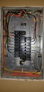

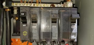

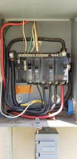

I am new to this community. Thanks for having me. Last winter I bought a 12x20 prefab building for a man cave. I ran about 100ft of 10/2 w/ground to it and installed a receptacle that I am running a small window unit off of. I also have a power strip plugged in that I use to power a TV and other small electronic devices. I would like to install a few other receptacles and some lighting. I will add that the incoming wire is buried in about 30 ft of conduit.
Question is do I need to install a subpanel or can I just keep adding to what I have?
The panel that runs this building has all the neutral and ground wires connected to the same bar. Anything wrong with that? Do i need to change something?
I appreciate any help and/or advice!
Doug
***Since posting this I have done some searching and found that a 30 amp 2 pole switch would be the way to go? Could I then use that to power some bus bars in a box that would feed the different receptacles and lights?
