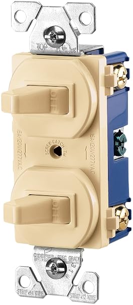

The switch that they are connected two really has two switches, one is the light and the other are the outlets.
First, by "one is the light", are you referring perhaps to a ceiling-mounted light fixture? Or something else?
Second, by "really has two switches" do you mean it is a "duplex"-style switch, such as:
http://www.cooperindustries.com/con.../toggle_combination_switches_271_275_276.html
These are usually intended for retrofit applications where you want to cram two switches into an existing single-gang box.
For retrofit? According to who? Ive seen these used in new houses all the time. Saves time, switches and wire!

By all my outlets I mean all my outlets in my bedroom. This includes the top and bottom outlet of each outlet fixture. Every outlet in my bedroom is controlled by one switch.
The first switch controls a ceiling mounted light (which will soon the light that is built-in with the fan).
The second switch controls all the outlets in my bedroom like mentioned above.
By two switches I mean, 2 single switches in a double gang box. I have a picture to help you out further.
Since taking this picture I've seem to do something where the lights/outlets won't even come on. I tried turning the breaker switch on and as soon as I do that it trips and the switch goes in the middle. I do know what I did since I didn't disconnect any wires. I simply pulled the switches out so I could take a picture.
There seems to be 4 romex wires/bundles/whatever behind the gangbox. I do now know why, I would think that even if the outlets were controlled by a switch they all would be in a series or something, but then again I don't know much. Also, the light switch has a black wire that goes into the outlet switch, I do not know why. Lastly, there is a red wire that goes to the light switch. I also don't know why.
OK, this helps clarify the situation significantly. And indeed, things might not be not quite as bad as they initially seemed.
OTOH, they are clearly not great, either...
By "the switch goes in the middle", I am presuming that you mean the toggle handle on the circuit breaker, NOT the wall switch itself -- correct?
From here, I can only guess; but I strongly suspect that "pattenp" is correct, and when you pulled those switches out from the wall, at least one of the connections was compromised.
Again, I can't be certain; but judging from the photo, it looks like you've got a mix of "back stab" and traditional "wire under screw" connections. The former are notorious for being flaky & unreliable, especially after they've aged a bit. It also looks like at least the red wire leading to the left-hand switch is not fully tightened down; but again, I can't be certain from the photo.
I would suggest that the first thing you do is re-make those connections, keeping all the wires going to all the same places (electrically), but avoiding the "back-stab" ports entirely. This will likely require making up some short pigtails using wire nuts, as it is not "kosher" to put more than one wire under one screw head. Be sure to use the same color and AWG for those pigtails as whatever you're connecting to. Your existing wire appears to be (and probably is) AWG 14. So go buy yourself a foot or two of 14/3 NM-B (commonly called "Romex") cable at your local hardware (or big box) store, strip off the outer jacket (being careful to not damage the insulation on the individual conductors), and you'll now have plenty of raw stock to make the pigtails. This will cost you less than a dollar; spend another half a buck on a small handful of appropriately sized wire nuts.
Work on one "corner" of each switch at a time, so that you can avoid getting confused as to which wire goes where. Never tie different-color wires together via either a wire nut or a screw terminal (yes, there are SOME situations where mixing colors can be appropriate; this isn't one of them). When you're done with this little chore, everything SHOULD again work like it used to, and you can move on to making the desired modifications.

I opened up the 2 gang box where the switches were and I pushed some wires in the back connectors. As of now, everything is working as far as the electricity goes. I still need to solve my original problem of bypassing the switch on all the outlets. I still don't exactly know how to do that quite yet.
Yes, I don't know why an electrician would make every single outlet connected to the switch especially in a bedroom, doesn't make sense to me at all hence why I am trying to solve that issue.
By the switch in the middle I meant on the breaker. Yes, it was a loose wire on one of the switches. Like I previously stated up above I have electricity again!
I want to be able to control the ceiling fan light with one switch and the fan with the other. I want exactly zero outlets controlled via a switch and want all of them on at all times. Just my preference :)
I'm almost positive the red wire it up where the ceiling light is. I asked someone who I went over my house when I was buying it if the second switch is for the fan and he said yes. I have also taken some outlet covers off and there is not a red wire in them.
As of now I would like to bypass the switch for all the outlets. Do I just connect the black wires that are connected to the switch to a wire nut besides the one that is connected to the other switch as well or what?
Thanks!

The only thing I can say is to get the outlets off the switch is to remove the wires from the switch that's controlling the outlets and wire nut them all together with one wire nut. Be sure to use a wire nut sized to hold the 4 of what ever size the wire is. I can't offer any help on using the switch for the fan without knowing exactly what wire feeds what. If you leave the switch in place just leave the ground wire connected to it.
Edit: The one wire that looks like its looped around the terminal will need to be cut, so you'll have 4 ends to put in the wire nut. Hopefully I'm talking about the correct switch.

Which wire is the one that looks like it's looped around the terminal?
For the wire that is attached to the left switch to the right switch, leave it connected to the left switch (the light) and take it off the right switch (currently outlets) and connect it with the other wires in the wire nut?

I talking about the switch on the right side of the picture. On my screen the wire looks like it's blue, but it is the wire that goes from the left switch to the upper screw on the right switch. The wire looks like it is looped around the screw on the right switch. Thats the wire I'm saying to cut to have 2 ends. All the wires less the ground from the right switch will be connected together with a wire nut. This is to just get the outlets off the switch. I don't know if you can leave out the wire running between the switches because I don't know where the power source comes from. The power could be coming from left to right or right to left. You need to use a volt meter to figure out what wire is hot all the time in the switch box.
Edit: You really need someone to come to your house to figure it out. It is near impossible to figure out with out being there to test with a meter and trace the wire as what can be used to switch a fan. To use that switch for the fan may require another wire to be run to control it separately from the light.
Glad to hear that you're back up & running. But DO heed what I said above about re-making those connections. As long as ANY of those "back stab" connections are left in place, the reliability of the entire system is at best suspect.
We'll get to that. But in the meantime, I'll point out that, at least as things appear to stand right now, you COULD side-step this whole issue by simply making a point of leaving that right-hand switch "On" 24/7. A shortish (2" or so) piece of electrical tape or similar placed over the toggle will help discourage accidental operation of the switch. Yes, this is a really "ghetto" solution; and personally, I would not want to live with it long-term. But it would undeniably be the simplest and easiest way to accomplish your stated goal of having the outlets live 24/7.
Understood. And if it really comes down to a choice between "no switched outlets" and "all switched outlets", then I'd have to vote for the former. But I really consider neither of those extremes to be ideal.
OK. I figured that was very likely the case; but it's always better to be as clear as possible in one's choice of words, so as to avoid any possible misunderstanding.
And until you get rid of those back-stab connections, you're likely to have more incidents of "loose wires" in the future. Even the minor expansion/contraction you routinely get from changing climatic conditions CAN cause those things to fail.
In the photo that you posted in Post #9 http://www.garagejournal.com/forum/showpost.php?p=3382171&postcount=9, it APPEARS that the wire connecting to the "top" (or farthest right, as the switch is tilted) terminal of the right-hand switch was never cut to make the connection. Instead, a short chunk of the insulation was stripped off mid-wire, then that short exposed piece of the wire was "looped around" the screw terminal. This technique is a shortcut which is sometimes used when daisy-chaining a series of devices together on one circuit. I believe it's "legal" (someone with a code book handy can confirm/deny); but it's arguably not what I would call "Best Practice".
In any event, with only that one photo to go on, neither "pattenp" nor myself can be absolutely certain that this is actually the case; but that's how it APPEARS to be. If so, then that wire will need to be cut (and probably a bit more insulation stripped off) in order to make it into two individual bare "ends" before it can be connected to other wires via a wire-nut.
IF we are all guessing correctly, yes.

The switch on the right, the black wire backstabbed on the bottom terminal could be the wire to the outlets. If that wire was put on the other terminal it would be hot all the time. That might be where the electician made one mistake. The non used screws should be tightened down to make them less likely to short against something else. Back stabbed outlets and switches are a fire hazard if the circuit is close to capacity, they will get hot. Also don't like the neutral connector as it is a light duty connection also.

The left one controls the lights where as the right one (the one with a bunch of black wires and NOT the red wire) is the outlets.

Based on what I see one of the black wires on the bottom of the switch on the right should be your plugs, the other one of the black wires on the bottom should be part of the 14-3 cable that has the red wire in it.
The black wire that is part of the 14-3 cable should be the wire that controls the fan, you should find it in the ceiling fixture wire nutted when you go to install the fan.
Move the other black wire to the other side of the switch and I bet your plugs work properly.
I would get rid of the back stabbed connections and pigtail as needed as well at this point.
If this isn't clear enough I can provide better detail tonight after work.
