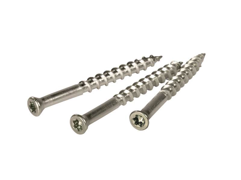

rlitman
Oct 18, 2010
24,581
Long Island
... I prefer to drill the flange then countersink the hole before using a stainless steel Philips head oval sheet metal screw. The seal should be “preloaded” against the door slightly so that it retains a tight seal against the door panel.
Another option would be a trim head stainless screw like this:
The head is so small that it's not worth countersinking it in the foam based material. Just drive it flush.
As for the pre-load: yes, exactly. Roll the door down, hold the seal up so that it makes contact all over, and screw it in place.
