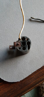

Run of 4 outdoor lights, all work except the first light in the run.
I measure 110 volts between the center contact and the threaded part.
Tried known good bulbs, they do not light.
I cleaned the center contact with sandpaper, it's shiny.
Fixture is 50 years old.
Is this just a bad fixture that needs to be replaced?

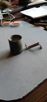

I need a new lamp holder if I can find it.
The connection to the black wire did not look good, I pulled it off by hand.

The easiest and cheapest thing to do is buy a floodlight lampholder and take the socket out. You will probably have to recycle the existing bracket.

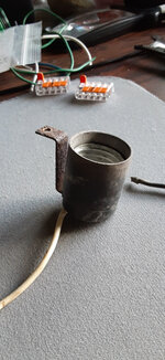

The mounting bracket is held on by a screw.

Home Depot used to sell sockets, either by the fans/pendant lights or over by the outlets, I can't remember. Amazon probably has them too
