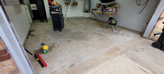

After prepping the floor for epoxy coating. I acid washed the floor twice and degrease.
Should I use a Rust-Oleum Recoat Primer 1-part Gray Flat Concrete and Garage Floor Paint to prime the floor? Link to Rust-Oleum Recoat Primer
What's the better epoxy paint to use? Rust-Oleum EpoxyShield or Rust-Oleum RockSolid
Before:
After: Still need to clean behind the fridge.

Do not use the Rust-Oleum Recoat Primer. It is intended to be applied to bare concrete that has previously been sealed or for application over an older coating that is adhered well. It is NOT intended for bare unsealed concrete, particularly concrete that has been prepped via etching. We have an article here that discusses it.
RockSolid is a better coating than EpoxyShield. It's much glossier, more resistant to hot tire pickup, and will wear longer. Like EpoxyShield, however, it's a thin coating. In addition, it penetrates concrete much better. Due to the more aggressive etch of the surface, it may require two full coats to get the minimum mil thickness, color uniformity, and gloss. I suggest reading our article below that discusses the facts about RockSolid. There are actually much better coatings you can apply for almost the same amount you would be required to spend on RockSolid. Sinlge-part polyurea is a great example. I posted that below as well.

2 more gallon of Muriatic Acid.
This time I forced on the smooth area. Now it ready for the epoxy paint this weekend.
Look like rain Saturday.

Yikes... As a note for others, many acid etches without neutralizing can create long-term problems. Rinsing with water does not neutralize it. It just washes the acid off the immediate surface. The acid solution that was able to penetrate stays active, even if it is partly diluted with multiple rinses. The active solution can slowly deteriorate the concrete as well as cause corrosion issues with the rebar.
...It can also attack the coating to concrete bondline increasing the potential for future delamination. We've seen situations where a floor is coated during the dry summer months and all looks good but then the coating pops in the winter due to rising moisture levels driving insufficiently neutralized acid up towards the surface.
A couple of additional tips: *Do NOT use high pressure water when neutralizing/rinsing. Instead flood the floor and squeegee out or vacuum up the rinse water. High pressure water can drive the active acid deep into the concrete pore structure. *Verify that the acid/etch has been sufficiently neutralized by testing the rinsed concrete with pH test strips available at any pool supply store. The correct pH should be between 6.0-9.0 with 7.0 being ideal. If the pH is below 6.0, neutralize again.

Here some before and after pictures. Took 3 bag of Rust-Oleum RockSolid for 360 sq ft garage.
Will recoat this Friday and add paint flacks.

Just seeing this post now.
I did power wash the acid out of the garage but did it 3x time. Used a squeegee to move the water out too.
I hope I done have any problem.

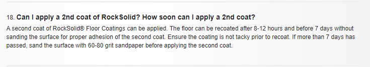

It seems to me like you are rushing it and not installing this properly. The acid must be neutralized before you coat it. You are probably going to have delamination issues in the future. I'm curious to why you did not neutralize the acid. Pressure washing only drives it further into the slab.
Since you coated this on Sat or Sun, and aren't going to do the 2nd coat until next weekend, you're going to have to sand the entire floor because your re-coat window is gone. Typically you want to re-coat within 12-18 hours to stay within the re-coat window and avoid sanding.
Rust-Oleum said you can recoat with in 7 day.
