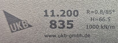

85° tooling requires Air Bending. Thus bring the Ram down bending the metal over 90° allowing it to spring back to 90° as the pressure is relieved from the Ram. Trick is, where do you stop before bottoming to get the spring back at 90°.
How I would do it is add a measuring device as @Firebrick43 mentions, something accurate to .001. Without any material between the Punch and Die, bring the ram down applying pressure to the Die with the Punch and bring the tonnage up to 5 tons. Zero your measuring device. Now put the material in between start the bend and bring it up to as close to 90° as you can eyeball. Record the distance noted on the measuring device. Check the angle and keep hitting it and recording that number until you achieve 90°.
That will give you a good baseline for that particular thickness and bend length. Keep in mind the longer the bend the deeper you may have to go to get 90°. Based on that Ram design with all the pressure in the middle the ends of a longer part may be slightly open due to flex in the system. So be consistent where you take you angle measurement or you will be chasing your tail.
On thin materials or very narrow parts, material thicknesses or widths where just the weight of the Ram and Punch can deform the material with zero pressure it gets a little more complex but following the same process can yield accurate angles. What I mean is unless you are taking the "backlash" out of the system you can have variations in the angles on lighter gauges or widths.
Bottom Die selection for the thickness of the Material is critical. Tighter is better for accuracy but requires more tonnage and depth of the Punch becomes more critical to hold 90°. My rule of thumb is 5 or 6 times the material thickness if the Punch radius is .031 ( or if metric tooling 1mm) or less. Bigger than .031 (1mm) use 5-6 times material plus the Punch Radii.

I've attached pictures of both the die and the punch.
Seems like the nose radius of the punch is 0.8 mm and has a matching V of 85 degrees so the same as the die.
The V sizes and specs are mentioned on the die.
According to my calculations, since the length of the die is 83.5 cm, the max tonnage that can be exerted safely is around 65 metric tons.
Currently bending 2.5 mm mild steel. That being said however, what is the thickest piece that I can safely bend without risking damaging the die and/or the punch.
If the largest V is 50 mm wide, can I safely bend 8-10 mm as that is what you mentioned if I understood correctly.
Also, will a smaller V result in a tighter bend radius?

I have a breakfast meeting this morning so I'll answer a few questions addressing the part you are bending and a few things on safety.
More later tonight...busy day ahead!!!
2.5mm thick material:
Use the 16mm V in the die. 12mm or 14mm would be a better choice but you don't have that option.
The max tonnage without damaging the tooling is based on material hardness, length of bend and thickness of the material.
As noted in the pic of the Die, V = 16 @ 85° use a 2mm Radius Punch, however your .8mm punch is perfectly acceptable and will use less tonnage to bend the material. We use .8mm punches up to 6.35 thick material in most cases.
Your Die is good for 800 kN/m. As long as you do not exceed that you are fine according to the manufacturers specs noted. A 100mm long bend will take 10 times the force than a 10mm long bend in the same material.
Your Punch is rated for 1000 kN/m which seems a little high to me with that small of a Radius???
I need to dig into the manufacturers site.
More later...gotta run!
