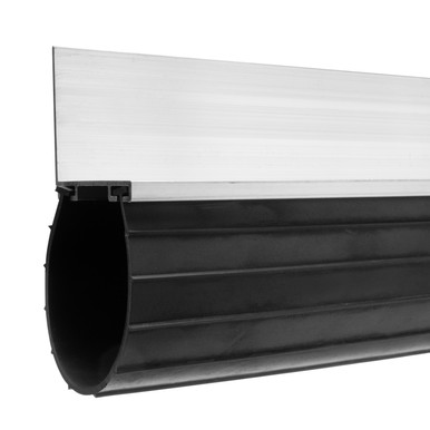

Since I bought my house I have struggled with water coming in under the garage door. The garage was built in 1973 and is a detached, oversized single car garage. The drive way is 60' or so long leading up to it and then slopes down towards the garage door the last 15'. So water will always be running toward it. At some point, someone hammered out the asphalt of the drive way and attempted to concrete in some slight curbing to help direct water away from the garage. The west side does an ok job as long as I keep sand, snow, ice etc clear. The east side goes right to a garden bed. I dug the garden bed 1-2" below the concrete on the east side and usually does an ok job unless it rains really hard for long time, 30 mins or more. The floor and door are not level after 50+ years, so I replaced the seal on the bottom of the garage door but only makes contact in the center, where there is no water intrusion.
So I was looking at some of these rubber garage door thresholds to put on the floor to try and close up the gaps under the door and help direct water to stay in the concrete gutters. https://www.amazon.ca/Jin-Bao-Unive...c1f91183f56a3d04ff6204282c1&gad_source=1&th=1
Has anyone tried anything like this? It seems to me most adhesives don't take to concrete very well. But I was thinking about using construction adhesive and then maybe some tap cons with big washers to help keep the threshold from lifting.

I don't think you'll ever be able to make a water-tight seal at the base of the door. My dad had this same issue. He cut a rectangular box out of the concrete just in front of the door and installed a drain the entire width of the door that led further away and lower than that area. Has not been a drop of water inside since, and his doors are old as well and don't seal well.

My neighbor did exactly this. Our street floods and when cars drive by he gets wave action against his doors. He said it helps his issue.
He put 3 pieces in a U shape with mitered corners directly on the garage floor inboard of the door. The door does not sit on them. This is because his door sits in a recess about an inch below the garage floor. He wanted this new curb as high as possible.

There was a thread here 1-2 years ago w/ links to the bottom of the door seals that were maybe an inch think, maybe a little more. They were fairly soft so they could help seal up problems like you have. Sorry I don't have a link for you. I'd be looking for those seals before doing anything else.
I did find a thread, but it seemed like they were mostly talking about steel thresholds from commercial applications. I'll keep looking though.
They make extra tall astragal rubber too.
I shoved a piece of caulk backer noodle into my garage door seal. It made a world of difference.
Maybe trying to make the edges of the seal on the door bottom thicker/stiffer would help too. Thanks for the suggestions!

Some sort of drive-over threshold really could help you here temporarily. Obviously, gravity is better. If you ever get the chance to install some gravity, that'll be better.
I would just go nuts with something like this https://www.amazon.com/Weather-Defe...Threshold/dp/B07F2PCXLR/?tag=atomicindus08-20
If it's a hobby garage and you're not driving over it 4 times a day, might last forever.
I was wondering what kind of adhesive might be best for this? Sometime over the summer I'll lay it down to get the best odds of adhesion.

It comes with adhesive. Prep is always the important part, clean, possibly with muriatic acid etc. You have wood in contact with soil and rotten jambs too, so as you mention, getting the water away from the structure externally is key.
