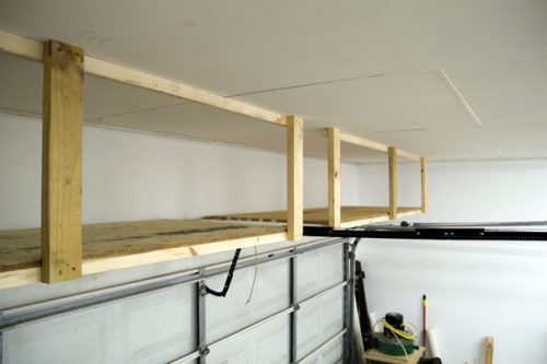

What are you guys using for overhead garage storage?
I have vaulted ceilings in a 20x25 garage with a lift. There is room overhead at the garage door that I can try to make something.
JUst looking for options, let me know what you think.
Thanks

I built some simple shelves with 2x4's, OSB, some joist hangers and wire rope supports in the centers. Not for real heavy storage, but they keep a lot of stuff off the floors and other storage areas. All of our Christmas decorations are up there (and staying there this year, because we're leaving town for the holiday....no point in decorating or putting up a tree LOL).
I'll try to get a pic of them tonight for you. There's a lot of wasted usable space there above the header. Everyone that sees them comments about how good an idea they were. I doubt I have $100 ******* into building them.:beer:

I ran unistrut across the ceiling using ledger lock screws into each joist to spread the load out. I then hung 3 4x8 sheers If ¾ ply from the unistrut using all thread. It’s extremely strong and gave me a ton of storage in the wasted space above the garage door.

thought about it again today and I dont think the space over the door is going to work. The garage has a lift and if its a large vehicle then the vehicle will not clear the shelving.
Im starting to look into some sort of soffit shelving along the sizes. I would need to attach something to the slanted ceiling....
