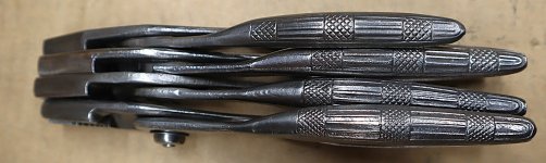

These Oxwall pliers all have similar designs and handles. The first on uses a through pivot bolt, similar to Utica model 513. It is not marked Oxwall and the Germany would indicate either before WWII or after Reunification in 1990. However, based on the insides of the handles I think these were made just before WWII in 1939. The next pair is marked Oxwall Tool Co. Germany British Zone. Then one simply marked West Germany. Last is a slightly smaller version marked Oxwall Germany using a newer design for the logo. Please note the 1372 cast into the underside of the handles. This same number is on a group I will post soon.
General note. None of the German pliers I have are marked on the insides of the handles until after WWII. All marking are stamps. After WWII they started casting descriptions inside the handles. On Oxwall pliers all these cast marking are above the handles. Other makers used an inset area.
