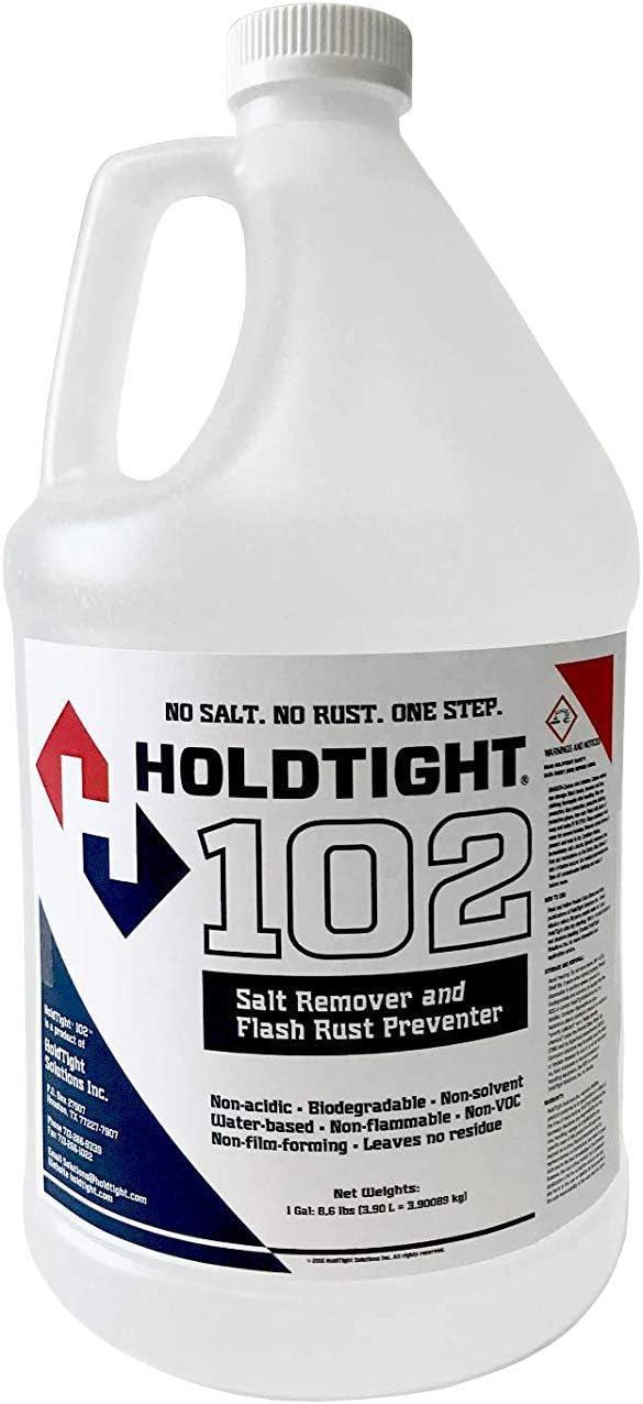

^^^THIS. Soda works just fine on fiberglass parts. Just be sure to wash down before paint with a correct solvent to neutralize the soda. Holdtight 102 is the preferred wash. The soda horror stories all over the web are apparently posted by people who didn't follow directions.
