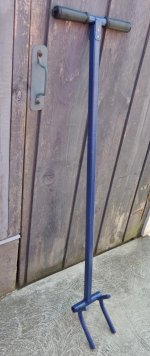

These were all painted using my Fuji semi-pro 2 stage turbine HVLP:
SW all surface 100% acrylic:
This is clear, not paint but figured I'd show it anyways. This is pre-cat laquer, stuff dries to sand in an hour!
This was sprayed with a King automotive style gun, paint is SW urethane alkyd enamel
Ainsley
Jun 12, 2014
557
Ontario, Canada
Looks a bit like a "Beaver" lathe.....what colour is that and what does the paint cost??
http://www.sherwin-williams.com/hom...ItemUrn=&jN=&aN=#color-product-search-results
Good eye, it is a beaver lathe! The paint colour is a custom match, I can pull the code if you're that interested. The urethane alkyd enamel goes for about $35-40 per gallon. A nice step up from it is their acrylon 218 HS which is a two part polyurethane, stuff dries fast and hard and has great UV resistance.
As a side note I used SW corothane MIO-aluminum as a primer, nice stuff to work with and is the best I've found in a one part primer for marginally prepared surfaces. Looks pretty neat by itself too:
I should note that all these paints are pretty nasty to spray and I always use a 3M full face mask with organic cartridges.
