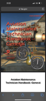

Attached is the site I suggest you refer to. Chapter 8 specifically. In my experience the A&P maintenance and mechanical technicians are mainly within the areas of literal airframe and power plant divisions of their company and painters are separate and their is so much involved in the correct way to do this. Specific airflow, humidity, ventilation…. Correct and precise coverage of all ports, antennas, engine components ad infinitum.. I’m a diy’er of many many things. I gather you’re being honest about the mechanical aptitude you have. This shouldn’t be a lone task. Very unsafe, I know this simply because your omitted, highly important info… The Planes Make! Maybe if you like I can forward your info to one of 6-7 current painters that literally do this daily and know the FAA side of all this project of yours. Just felt I had to share my insight and insistence of it being way more than I feel you know you’re getting into with this. Even I wouldn’t try even if I’d had the right paint gun, booth and paint.
