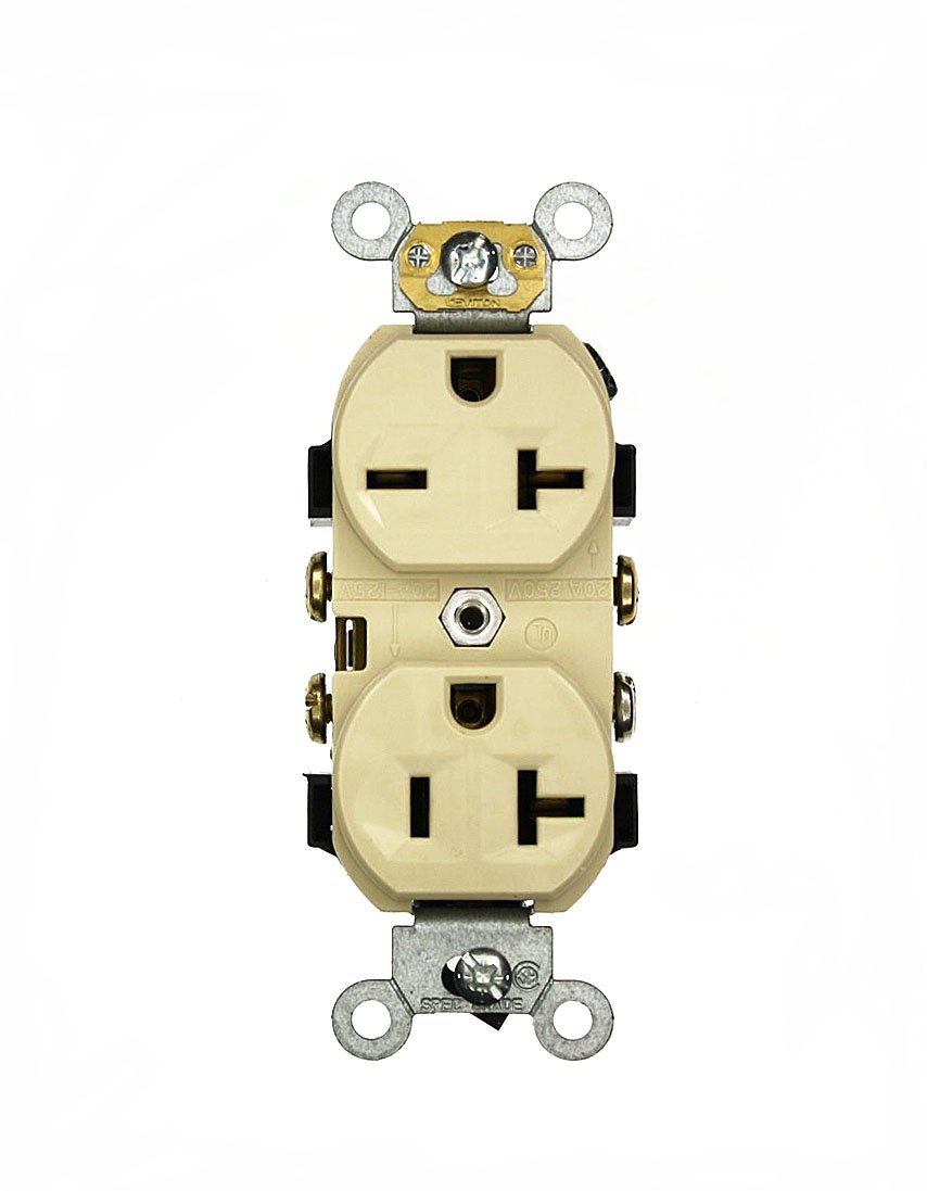

I think I'm ok on the water heater. One more question though. I'm planning to put a 220V outlet outside which will be covered under the lean-to for a compressor. I was thinking I may also use this outlet to backfeed with a generator. I was planning to size the wire and breaker for 40A circuit to handle the generator. (I can install a 20A breaker for the compressor and swap it to a 40A if I want to use the generator).
Does this sound like a good plan? Also, can I mount the outlet in this box? It says it is rated for 15A or 20A receptacles.
http://www.aifittings.com/catalog/inbox/two-gang-low-profile-in-box/DBVM2W
Note: Meets 2015 CEC (Rule 26-702), NEMA 3R, NEC 406.9 (b); Where a weatherproof-in-use cover is

Next question. I want to install this combo 120/240 outlet in the ceiling to use for plugging in a 4 post lift. I also want to continue from this receptacle to another 120V outlet for a garage door opener. From my research, now GFCI protection is required on all outlets in a garage, even if it is in the 10' ceiling.
Here is the outlet I'm planning to use:
Leviton 5842-I 20 Amp, 125/250 Volt, Narrow Body Duplex Receptacle, Straight Blade, Commercial Grade, Self Grounding, Dual Voltage, Ivory
https://www.amazon.com/gp/product/B000U3BVMI/ref=ppx_yo_dt_b_asin_title_o02_s00?ie=UTF8&psc=1
Can I run 12/3 wire from panel to this receptacle, then 12/2 to a 20A 120V receptacle from there?
Also, is this breaker the only way to achieve GFCI protection on both the 120V and 240 receptacles? This is the conclusion I have come to after my research.
Square D by Schneider Electric HOM220GFIC Homeline 20 Amp Two-Pole GFCI Circuit Breaker
https://www.amazon.com/Square-Schneider-Electric-HOM220GFIC-Homeline/dp/B00L40PKFK/ref=sr_1_1?keywords=HOM220GFI&qid=1552919466&s=gateway&sr=8-1
Thanks for any help!

250V don't need GFCI protection unless changed in 2017 NEC. It may be cheaper to run regular 240V circuit for lift. And extend off an existing 120V circuit using a dead front GFCI for the garage door opener. The 2pole GFCI breakers are expensive. Also what is the HP rating of the lift motor?
I haven’t decided on a lift but I know it won’t draw 20 amps. It will be a typical 4 post storage lift. The receptacle above would work if I decide on a 120V lift or if I want to install a drop cord reel at the same location as the 240V lift power.
So, to power the 120V side of the combination outlet, I would need a separate 12/2 cable from the load center, run through a GFCI, then into this receptacle box. I was hoping for a cleaner installation using fewer breakers and fewer wires. Although a $10 2 pole breaker + a $5 1 pole breaker + a $15 GFCI + 20 ft of 12/2 romex is much cheaper than the $100 2 pole GFCI breaker.
Am I allowed to run 2 12/2 cables into and 2 12/2 cables out of a 1 gang box? (I plan to install multiple 120V240V outlets in case I move the lift from one bay to the other.)

A cleaner installation would be using 2 separate receptacles. youre trying to cram too much into one j box.
How is 2 breakers, 2 cables, and 2 receptacles cleaner than 1 breaker, 1 cable, and 1 combo 120/240 receptacle as in my original (albeit expensive) proposal?
Cheaper, yes, but takes up an additional slot in my panel and uses twice as much cable.

Personally I don't like MWBC's. I like circuits to be independent based on use. If you don't mind having to put out $100 for a GFI breaker then go for it. You just need to be mindful of the possible total amp load you'll have on that circuit. Use a large box with a single outlet face plate so you are not fighting for space to connect wires.

10-4. The only thing on this circuit will be ceiling outlets for a lift and 2 garage door openers. I also would rather not mount a GFCI plate on the 10’ ceiling.

The GFCI device can't go on the ceiling anyway. You'd have to add a box down on the wall for the dead front GFCI or a GFCI outlet. GFCI device has to be in a readily available spot.
