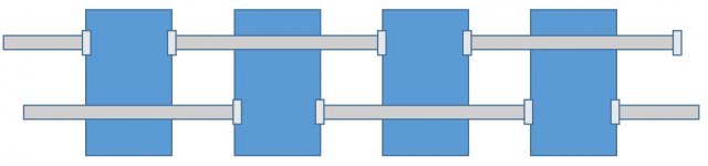

Passing EMT conduit through a box
600SL
Apr 26, 2012
1,801
Connecticut
I would like to run two duplex outlet circuits with an outlet every 5 feet and each circuit powering every other outlet. It would save a lot of trouble if I could pass the EMT conduit right through the box to avoid bending around the boxes. I cannot find anything in the code that says you cannot do this but I never seen it done. I have attached a picture to show how the conduit would either pass through or terminate within the boxes.
The only thing I can think of is that I would have to subtract the volume of the EMT from the box volume. This should still leave plenty of volume because I will be using 3.5" deep boxes. The code states that conductors that pass through the box don't count but it doesn't say anything about conduit passing through the box.
Your thoughts?
John

You only need one pipe from box to box,if you wanted two circuits then you pull black,red,white and green if you want an extra ground. Then your just passing the wires through one box to the next.

why do you need two pipes? just run one with two circuits in it.

I am pretty sure there won't be enough room to do what you are thinking. One conduit is all you need. A white for each circuit ensures no issues.
I would think if you offset your boxes so the conduit would pass over/under the other set, you have what you want

The Edison circuit or shared neutral is legal here in NC. But would require bridging the two circuit breakers there by making them effectively one circuit. This is what my local inspector told me.
There is definitely enough room in a 3.5" deep box.
I would have loved to run 4 wires in one conduit but the way I understand the code, over three requires de-rating, driving the wire gage from 12 to 10.
I have considered the over under but I think it wouldn't look very nice.
Right now this looks like the cleanest option but haven't seen it in use.
Nobody does it that way because you only need one conduit.
You're only required to use a 2 pole breaker if the two circuits are sharing ONE neutral or both circuits land on the SAME duplex receptacle.
If you are running two hots and two neutrals leapfrogging your boxes two single pole breakers will suffice. You have no issues using #12 thhn, derating is not a problem.

OK now you have me reaching for the code book. My understanding was over 3 current carrying conductors required derating. I am using #12 thhn. Is it 3 current carrying conductors or 3 hots or do I just have this all wrong?

Yes for the fill tables its something like 9 conductors. My understanding and I'm hoping I'm wrong, is that once you go over three conductors the ampacity of the wire needs to be derated. Therfore #10 wire would be required on 20 amp circuits.

These will be 20 amp outlets. boxes will be about 4' off the floor. If I can get 4 conductors and a ground into 1/2" EMT without derating that would be good.

you can use the 90 degc column when derating thhn. that means you are ok in this application
OK just looked this up. Using the 90° C THHN column I'm good for 30 Amps at 80% derate I'm still good to 24 Amps.
Hell maybe I can pack some 240V circuits in there as well.
Thank You gentlemen.

I did come to the conclusion that #12 derated will still be good for 24 amps
I would have loved to use 4" square boxes but they wont fit with my corrugated steel wall panels.
Looks like I have this figured out with a single conduit.
