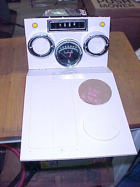

I use all kinds of stuff. Foam core board, old filing folders, heavy cardboard, you name it.
Some of the patterns I've made:
Here is a console I am currently building for my '56 wagon. Foam core patterns.
This is a layout for the top. Foam core.
See the cardboard circles? Cupholders...
