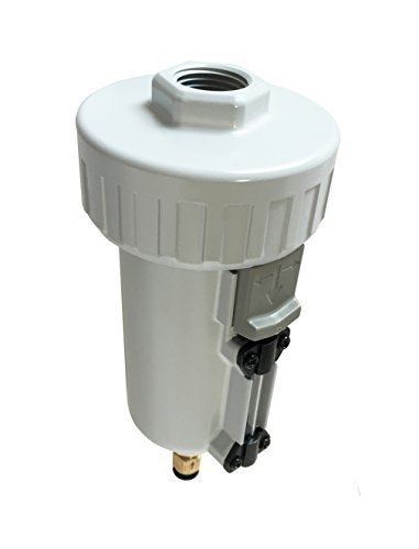

Have you found one of the silly things that actually keeps working? I have had spotty results with autos. A bit better with normally open but I dont drain pressure daily. Rebuilds kits always get a blank look or long wait.

PneumaticPlus SAD402-N04D-MEP. Float, normally closed. How would I know how long before a rebuild? I clearly stated that I picked them up for my planned system, virtually all the components for which I have now on hand.
I would not be overly concerned about the cost of rebuild kits for such simple equipment that protects your much more expensive air tools and equipment.
Sorry, didnt mean to say you had an ugly baby. I have found the things to gunk up and either never open or constantly ( or worse, intermittently ) leak. Nobody looks at the things because they are "automatic ". Rebuild kits get lost. Backorders are long. Parker, SMC, or Ingersol are all the same. I thought you knew something better.
I must have missed that "clearly stated" part. Its not the "cost of rebuild kits". Its the "am I ever gonna be done with this ****" so I can forget it and move on.
I am on the road to something manually operated only. If you knew my love of the detailed and complicated, that would shock you.
