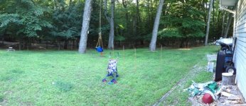

Hello everyone, I'm planning a garage build for next year and I'm trying to get everything planned out. What I know now is it will be stick build with 2x6's and unless it costs more than I think I will be going with a 36x48. This is mainly to store the toys and have a nice work shop. I'm open to all suggestions on every phase of the build from foundation techniques/processes to insulation. I may need to do the build in phases, as in the foundation one year and then put up the framing the next, and then insulate and finish. Thanks in advance for all the suggestions.

I've uploaded (I hope) my current layout of where I'm planning on putting the garage. There are several factors why I choose this location. The house is on a hill, and where I have the new garage drawn in the back 1/3 of it will need to be filled 6-8 feet and the front 2/3rd's will need about 1-2 feet. As you can see my well will be centered on the two 12' doors I have in front (this well has been driving me crazy ever since I started thinking about building a garage). The left side of my property the neighbours are fairly close, the right side they are back in the woods a decent amount. I also tried to upload a picture of the area I will be putting it. I steaked out each door and corners of the garage (you can't see the ones down the hill). Any thoughts?
