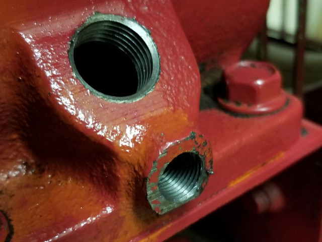

Here's the damn thing, stuck to the threads.
I've got dental pics, needle nose pliers, I'll try heating it up and picking it out trying not to get anything bits in the crankcase.

Ok, this is done.
I won't be doing this again if I can help it; if I buy something that has oil to drain, I'll be sure and check the plugs.
If it gets frozen after I buy it, and I can get the oil out another way, I'll quit while I'm ahead.

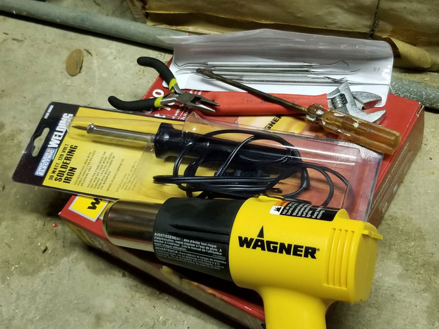

The dental pics didn't work, the file didn't work, the little soldering pen didn't get hot enough, and just heating up the plastic didn't work. I was pulling out bits that were too small and nothing was coming off the threads.
Tried the heat gun, setting it on 1000, holding the screwdriver directly in front of the plastic, and heated the crankcase around the plastic, the plastic, and the screwdriver, put the heat gun down quickly and started scooping and twisting the screwdriver like a little shovel and got out a big chunk off the threads, so doing this worked.
95% of what you saw in the original pic came off in about 8 or 9 chunks heating everything up and working this w/the screwdriver quickly.
Heating everything until I could see the plastic getting dribbly and twisting and scooping until a big chunk came out. Everything would cool in a few seconds, and the good thing about that is that most of the chunk would stick together leaving no residue on the threads.
Go figure.
I took a pic of the chunks here, sitting on the box of the heat gun, this is 95% of what you see in the original pic of the plastic frozen on the threads. Burned up w/what looked like sowing thread all through it.
Here's a pic of everything I tried on this.
Here's a pic of this finished, and the threads. I think I scuffed a bit of the 1st thread and the rest of the threads look ok.
Actually, Ducksface advice was good advice, and this is what I had to go through because I didn't follow it, so my career doing heart surgery on frozen drain plugs is over.
