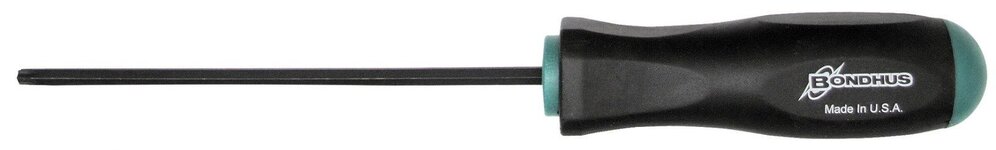

Bondhus works for me, but would have to buy T27 and T30 individually, which they do sell: Bondhus Stardriver
Bondhus Torx screwdrivers with soft grip. Look no further. Super comfy. :)
With a $50 budget, No China/Taiwan, and no acetate stipulations I think Bondhus is your only option. I like mine a lot and they have held up well for me but the shanks are pretty long. It's never a problem for me but they can be a little awkward at times. I really wish Bondhus offered these in a shorter length as well.
Otherwise I'd give the US made tekton a good look or see if you can get a Mayhew Trilobe set in your budget.
