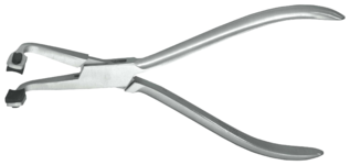

I got to considering dental plier; and behold, crown removal pliers, soft textured grips on both sides.
Looks like they can be had in an assortment of orientations.
