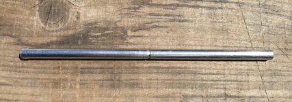

How long is the one in your kit? I have one that is 17" long...
What is the significance of the up and down arrows? I thought AA'd said it was a mystery...
Oldtuleguy
Nov 4, 2017
10,462
13 1/2". Don't know about arrows
