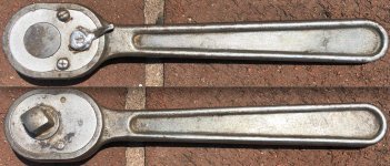

Here's a few Plomb pieces for discussion.
The [S.R.] stamped ratchet is obviously Plomb made, as is the universal joint. The 1/2" drive socket looks like it's WF marked counterpart.
The lot came with a long extension , t-bar handle, and sliding T with similar finish, but otherwise unmarked. The sliding T is consistent with it's WF marked counterpart as well.

31,060
The [S.R.] stamped ratchet is obviously Plomb made...
That's a missing link, Unaiu!
"We" (those of us who own and have discussed sockets with the [S.R.] branding before) have "known" (as best as we can know without definitive historical documentation) that the sockets were Plomb made by eyetest and measurements (credit R_olson6!), but I have never seen a ratchet, I don't think anyone else has, either, and, if there was still any doubt, that pretty much definitively nails the Plomb OEM connection. I wish the stamping was identical to the stamping on the sockets that have been found (i.e., "[S.R.]"), with the periods after the initials, and a complete rectangle around them, because some may question those differences, but I am convinced.
It doesn't help resolve who Plomb made them for (I am on record stating that I think they are production for a user, not re-sale/re-brand, and one completely speculative guess I have made is Sinclair Refinery), but it's a significant find.

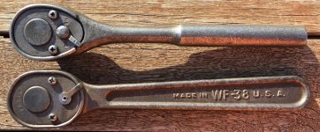

I picked up an early Proto N-38 ratchet yesterday. Plain steel and unfinished handle (no knurling). I took it apart to service it and the inside if very crudely finished as well. Very industrial feeling.
I forgot to comment on this the other day, but your posting in the ratchets thread reminded me.
I wasn't aware of a Proto ratchet with an N-38 model number. Assuming that's a 1/2-inch drive rat, what's most interesting to me about the ratchet is the model number. It correlates exactly to the wartime US Army Air Corps Plomb WF-38 model number, and the post-war Proto WF-38 model number, with a different prefix. Akin to the way some wartime P&C tools (DBE wrenches, drive tools) with an N- series model numbering scheme correlate exactly to their WF- series model number counterparts, but with an N- prefix. We know that P&C made WF-series tools, and, that they had their own contract with the US Army Air Corps. We don't know if the P&C tools with WF- series model numbers were made under that contract, or if they were made for the Plomb contracts, and we don’t know who the N- series tools were made for. More on that discussion in the P&C thread, starting somewhere around page 19.
The big difference here is that the P&C N- series tools were wartime production, whereas your ratchet, like its apparent cousin, the Proto WF-38 ratchet, is clearly post-war, and post-Plvmb. Not that we even have a definitive explanation yet for the Proto WF- series drive tools that show up, but this Proto N-38 seems to be separate production, in the same way that the P&C N- series tools were separate production.
Does anyone know if there is a whole set of Proto 1/2-inch drive tools and sockets out there with N- series model numbers matching the Plomb wartime WF- series numbers? Or, like the Proto WF- tools, are the Proto N- marked tools limited to a few ratchets.
Correct, the N-38 is a 1/2" drive. Here's a pic next to the Proto WF-38 that I have.
