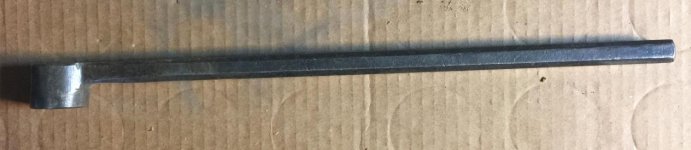

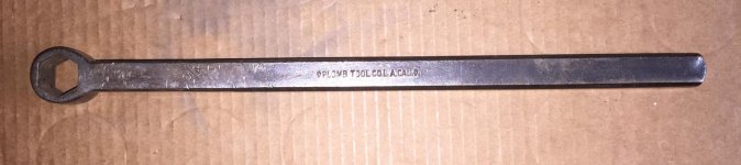

Picked up this Plomb 3/4" wrench today at an estate sale and it was suggested I post it here to get some info on it. Just wondering when it would have been made and how it was used. While I really do like Plomb stuff, I picked it up hoping it would be of trade value. Fyi, I haven't touched it to clean it up. Thanks!
r_olson_06
Feb 12, 2012
4,147
SD
I think it is a Ford main bearing bearing wrench. I know in the late 30s they switched to a double box end.
