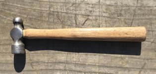

So what do you guys think the story is with this Paschall hammer, made for Ranger AT also having the Plomb stamp into it... Maybe made after the Paschall purchase but before the lawsuit was officially brough?
What you might have there is one of the hammers that triggered the whole lawsuit debacle with Fayette Plumb vs. Plomb Tool Co. And since Plomb purchased Paschall, I think it is a very safe assumption that this "Ranger" hammer marked with the Plomb name was made at the Paschall plant.
That is the first ball peen hammer I have seen with the "∇ PL∇MB ∇" marking on it. Very cool!
30,800
...one of the hammers that triggered the whole lawsuit debacle with Fayetter Plumb vs. Plomb Tool Co.
I'm curious what you're basing this statement on, Silverdeck. The lawsuit never mentions ball-pein hammers. In objecting to the use by Plomb Tool Company of its name as a trademark, it references "hand tools" several times. One paragraph includes the phrase "files, hammers, and other tools." There is no documentation that I know of associated with the original suit or the contempt suit that substantiates the common, popular theory that Plumb sued Plomb specifically because of ball-pein hammers. If you know of any, please share. I would be interested in reading it.
30,800
I couldn't find this wrench in any catalog...
Me neither, Ed. And I went through the 1925 page by page. Someone here, can't remember who, not a regular, just acquired an earlier catalog. You should ask him to go through it. I don't recall seeing MR. X's example, but that is one funky wrench. I have a bunch of "alligator" type wrenches and I've never seen one with an open end on the opposite end. It also looks hand forged, and the way the shank slightly tapers, and the raised heads, makes it even more distinctive. Nice find!
I didn't mean to imply that Plomb-marked (and marketed) ball-pien hammers were the only reason for the lawsuit, but were likely one of the reasons. In the the court opinion (Plomb Tool Co. v. Fayette R. Plumb, Inc., 171 F.2d 945 (9th Cir. 1949)), "hammers" were among the items listed that Plomb was ordered to "stop dealing in, selling, manufacturing and advertising.".
Here is paragraph 5 from the court's opinion:
"`5. The defendant is ordered forthwith to comply with said decree by causing its officers and employees to stop dealing in, selling, manufacturing and advertising hammers, files, and other tools the same as or similar to those listed in plaintiff's catalogue number 41, so long as such officer or employee is an officer or employee of defendant and the defendant uses the word "Plomb" as a trade-mark or otherwise and whether in its corporate title or otherwise and the plaintiff uses the word "Plumb" as a trade-mark or otherwise and whether in its corporate title or otherwise.'
(Source: https://casetext.com/case/plomb-tool-co-v-fayette-r-plumb-inc)
Lug, you did a pretty deep dive into this on a previous thread (https://www.garagejournal.com/forum/showthread.php?t=405038), so I trust your opinions on this topic. Just thought it was very interesting to see a Plomb-marked ball-pein hammer.

Lug Theres no Paschall markings. But, its identical to all my other Paschall hammers. I assume thats who made it. Did Plomb have hammers made by any other tool makers?
SilverDeck, so it says files as well... I dont recall seeing any Plumb marked files ever.... I do have 2 Plomb files but never see them in the wild. Maybe this is why they stopped making them becauee of the suit...
That's the paragraph I quoted from and alluded to in my first reply to you above, quoted also in my analysis for the deep dive you are referring to.
As I said above, that deep dive pretty much debunks the popular narrative that ball-pein hammers, specifically, exclusively, are at the root of the lawsuit, which is always inextricably tied to the equally unsubstantiated idea that Plomb's Paschall brand was part of some agreement the two parties reached in 1926 to avoid Plomb using the name of their company on the one tool that Plumb also made.
There is no record of such an agreement, and hypothetically, such an agreement makes no sense, since neither Plomb (or the just acquired Paschall) were even making ball-pein hammers at the time, and Plumb had no reason to agree to anything with Plomb, having just successfully ruined Plomb's TM attempt.
The point is that when Plumb objected to the use of the Plomb name as a TM in 1926, it could not have been about ball-pein hammers, and when they sued Plomb in 1947 for using the Plomb name as a TM without Plomb having a valid TM, it was not just about ball-pein hammers. Plumb always objected to any and all hand tools and packaging bearing the Plomb Tool Company name like a trademark, got their TM squashed for that reason, then came back two decades later and sued to make them stop using it like a TM.
Definitely interesting. Maybe OOAK? We can't know what prompted Plumb to finally challenge Plomb in court after twenty-one years of hand tool production, but I doubt it was a ball-pein hammer made on contract for Fairchild Aviation during WWII. Don's point is well taken there. If, as I opined on the deep dive, Plomb somehow unilaterally thought that simply branding one of their tools differently (i.e., "Paschall" ball-peins) would keep them out of court with Plumb, maybe they thought they wouldn't need to comply with their own strange little scheme for a miltary contract.
30,800
Paschall did not make your Paschall hammers; Plomb did. Paschall never made hammers. Plomb made Paschall-branded bumping hammers, probably in the former Paschall plant, in the late 1920's, after Plomb bought out Pashcall. The first Plomb catalog that includes Paschall-branded ball-pein hammers is No 11 (1932).
RagTopTA said:
...so it says files as well... I dont recall seeing any Plumb marked files ever.... I do have 2 Plomb files but never see them in the wild. Maybe this is why they stopped making them becauee of the suit...
Did you ever read my deep dive? I really think this conversation would be easier and better served if you do that, first. I linked it in my first reply to you in case you didn't read it before. The court documents refer to "tools" or "hand tools" multiple times. And I will emphasize that the line you are referring to says, "files, hammers, and other tools." That is a mighty broad "other." It would be unfair and inaccurate to read the court decree (demanding that Plomb stop using their name as a TM on tools and packaging) and reach any other conclusion than the decree being very broad. It does not specify particular types of tools. It pertained to ALL tools Plomb was making. And that's exactly what its effect was, in 1950, after a contempt suit in 1948, and a second contempt suit in 1949 (after the failed and ill-fated dual-marked Proto-Plomb attempt), finally forced Plomb to capitulate and use Proto and only Proto as a brand name for the tools that the Plomb Tool Company was making.
