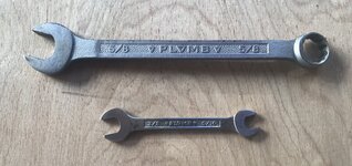

Here is all the Plomb from the latest find.
1370 plastic hammer
1150 DBE 1-1/16 x 1-1/8
1145 DBE 15/16 x 1
1230 combo 15/16
1228 combo 7/8
1214 combo 7/16
3425 Tappet 7/16 x 1/2
3047 DOE 15/16 x 1-1/16
3040 DOE 13/16 x 7/8
3034 DOE 5/8 x 11/16
47 3/8 x 3/16 pin punch
47 1/2 x 1/4 pin punch AD date code
5344 1/2 dr. 12-pt. 11/16 deep
5345 1/2 dr. 12-pt. 3/4 deep
5425 1/2 dr. 12-pt. 25/32
5424 1/2 dr. 12-pt. 3/4
5419 1/2 dr. 12-pt. 19/32
5416 1/2 dr. 12-pt. 1/2
5444 1/2 dr. Drag Link

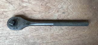

Here's another Paschall data point. Sorry if it duplicates prior examples, I tried to figure it out and quickly got confused.
I think a new handle is in order, if I shouldn't do that someone please let me know:)
31,058
If you mean the codes, the system proposes that the first letter is the month, and that the second letter is the year. The study was done exclusively with wrenches, hundreds of examples. It was discovered that none of them bear any first letters except A through L, or any second letters other than B, C, D, or E. 12 first letters, 4 second letters. Since there is already a known Plomb numerical date code that ended in 1941, it was a perfect fit for a date code from 1942 to 1945. Adding Paschall hammers to the study corpus has been very interesting, and thus far, they're falling into the parameters of the same letter combinations.
It could be my eyes, or the light, or the fact that there is no paint left, but it doesn't look hexagonal. My understanding is they were all originally hexagonal grip. If that's true, it's probably been replaced once. If it is hexagonal and worn or I'm just not seeing it, I would be tempted to try to restore it. Lightly sand with a block along the flats to try to sharpen the hex edges. And I might even be tempted to dip it in some green paint up to the shoulder. Then because I am kooky that way, I'd probably distress it a little to age it. But these are all subjective decisions. Nobody here will judge you for what you do.
saukit
May 29, 2021
574
Thanks Lugz, appreciate the succinct explanation of the date codes. You are correct, the handle is not hexagonal at all. It is also damaged with a large crack near the head. I’ll keep an eye out at future sales for a handle that is more appropriate, and maybe I’ll even dip it in green paint!

Nice haul! I wonder when all those wrenches were made? They don’t seem to have any alleged date codes.
