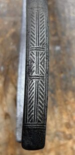

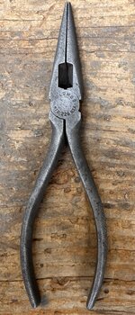

This plain steel but highly polished pair of diagonals arrived in the mail yesterday. I really didn’t like my rusty pair. When was this handle pattern used? A catalog search was inconclusive.08EE5880-E5BF-44C0-B1F0-99F8E8EEDFB4.jpeg376BDFC4-25C3-438C-90B0-3D78BCE8D9F6.jpeg35C24EF5-7AE2-4293-B0B2-6BB5CD119709.jpegA4B693DA-892F-4E28-BEBA-362E3909FE72.jpeg
That’s the Danielson “Union Jack” handle pattern. I don’t know exact years they switched but I believe it was towards the end? That pattern is present on Proto la pliers. I also have a dual marked pliers with the same pattern.

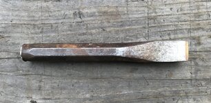

Another Plomb tool that arrived yesterday was this 86A 7/8 chisel with a 1” cut. I’ve never been satisfied with the Kraeuter chisel in my WW2 machinist’s set so I’ve been on a mission to find one close to the specified length of 9”. The Plomb one is listed at 8” so probably within the plus or minus allowance.A67C5576-CBE7-4890-BC3D-C2B40ACA1CB4.jpeg5EF5AED3-437F-4AD4-8433-7BD4B563D9C9.jpegI’ve started the dressing up and sharpening procedure but ran out of time.A30E1049-A31A-4386-8A79-3C0719613FCA.jpeg888620BF-49D9-4E82-B936-94548FB2B80B.jpeg
