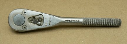

Oldtuleguy
Nov 4, 2017
10,486
I have one as well. Bit unusual.

@Catfishdan has one of those prewar teardrop WF-8's. We talked about it briefly back in 2019 when he first posted his ridiculously well-appointed array of Plomb midget rats.
What makes them even more unusual is that the first Air Corps contract in the WPB records was not awarded until January 1941. They had one earlier nondescript contract with the Army, no contract number, no agency, very small, awarded in June 1940. Note that there are no contracts earlier than that, for any mfgr/supplier, with any agency. That's when the WPB started keeping track of what they considered wartime contracts.

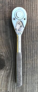

The commercial teardrops (1/4-dr, 3/8-dr) just had the ON OFF stamped there, right?
16,777
Here are two 1939 commercial 3/8” drive ratchets. I believe that the 1940 versions look the same. One came from Catfish Dan and was a detent donor.

31,073
You remember correctly, sir. Here’s a 5251 with a push through plug, a 4748 and a tear drop wf8.
Thanks, Dan. (You, too, OTG!) Most helpful. It's interesting to see how they used the space underneath the ON and OFF for the part number and/or the 1940 date code. I have to admit I was kinda sorta half-wondering/entertaining the notion of the plausibility of the WF 8 ratchets being made in 1940, but not stamped with the WF 8 marking until such a thing existed in 1941 with the first Air Corps contracts. As if they filled the early orders with surplus. But, they were not making a teardrop commercial 9/32-drive ratchet. I'm back to these WF 8 rats being potential proof of Air Corps contracts awarded before June 1940.

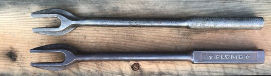

On topic, the pickle fork is the same situation as the puller pieces. All editions of the early Pebble Era catalogs (19-R, 19-R 2nd, 3rd, and 4th printing, and 19-R Reprint) show the old tools, not pebbled, but they could have been made any time late 1944 to 1947 just as well as the 1948 that Catalog 4820 implies.
