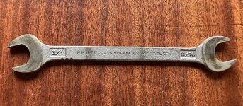

Anyone know anything about this one
I think to state the obvious it appears to be a war time production contract tools. I tried to use AI to correlate MPN to some contact or similar manufacture standard but I had no luck. Is it 1/4" or 9/32" drive?
