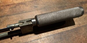

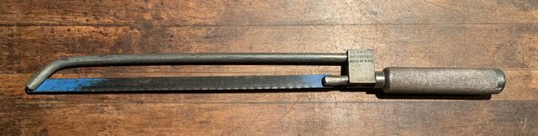

I didn't peel the price tag off of this 344 saw until after I'd bought it and was thrilled to see the PLVMB logo hiding underneath.
The compact design not only gets into tight places, it also takes up less room in the toolbox.
They only drilled into the handle two inches, so it's a hefty tool for its size.

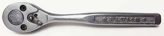

I added my recent chrome plated Plomb tool finds to the chrome tool storage box at my summer home and united my post war 1/4”drive sets along with my recent Plomb finds in a Proto box.IMG_2298.jpegIMG_2296.jpeg
IMG_0082.jpeg-Don

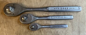

I went through and double checked the ratchets in the 1/4” drive sets. I found one that was plain steel and marked Made In USA rather than MFD so I switched it out with a more correct postwar example. The rougher finish of the plain steel ratchet is visible in these comparison shots.IMG_2349.jpegIMG_2348.jpeg
Some 1/2“, 3/8” and 1/4” drive pebbles.
Round handles.
Flat handles.

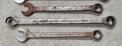

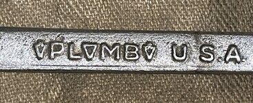

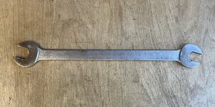

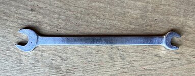

So....what is up with the last two wrenches pictured, 7792 and 7799? Raised letter or reverse stamping in what I assume is a standard wrench beam before the pebble handles and other recessed panel tools came along? Nice collection of logo variations.
So the 7792 pick is one of the 32XX midget wrench variations and the 7799 pic is a 1929 V series which they decided to mark differently on either side for whatever reason.

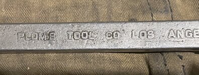

Here's a hopeless "item description" from an eBay seller that popped up today for a heavily pitted and size modified wrench. I have no idea what they're on about with the A.Plomb rant besides obviously cutting research a little short and not reading the California Tool chapter. Little optimistic on the target price...

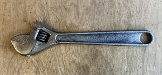

This dual marked adjustable wrench has plenty of rust damage but it was inexpensive because the jaw was frozen in place. With the help of some penetrating oil and WD40 I finally got it freed up. It will be added to my dual marked display box. IMG_2376.jpegIMG_2375.jpegIMG_2379.jpegIMG_2378.jpegIMG_2377.jpeg
