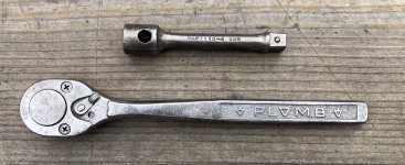

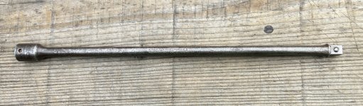

I bought these to get the NAF extension but I was happy to get the wartime 1/2” drive pebble ratchet as well. IMG_6968.jpegIMG_6969.jpeg
Nice! Is that a 4" or 5" extension? I just want to mark it in my catalog. Also is that an early Plomb rivit set?

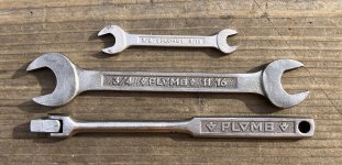

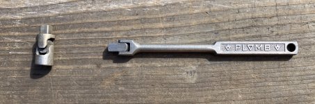

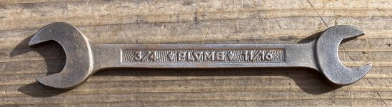

A 3035 pebble DOE wrench that I was missing arrived in the mail yesterday with a couple of other Plomb items. IMG_0079.jpegIMG_0078.jpegIMG_5046.jpegIMG_5047.jpeg
It came with these. The rusty 3020 is a duplicate.
The 3/8” flex handle is a little smoother finish than my recent estate sale find. IMG_7247.jpegIMG_7248.jpeg
Both are unplated.
Solid DOE pebble set! Those earlier 3/8" pebble breaker bars are one of my favorite of the pebbles.
