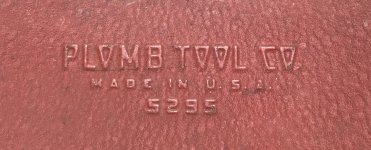

Looks can be deceiving, of course, but the tools looked they could be original to each other. Not onesy-twosied, as Roy alluded to. The whole set, including the box, has that vibe.
While it may be odd to see "PLVMB LOS ANGELES" era marked sockets in a "PLVMB MADE IN U.S.A" era box, the production was not decades apart. As Don alluded to, the opposite - with later "PLVMB MADE IN U.S.A." tools put inside a seemingly endless supply of older "PLOMB LOS ANGELES" boxes, was certainly true, and well known. But the weirdness doesn't end there. Not every 3/8-drive speeder fits in every 3/8-drive box, which is maddening, and indicates some strange sources.
Within that context, who knows how long they were still using up old stock LA tools when the newer MADE IN U.S.A. boxes were introduced.
I'm not arguing the box is original to the set. I'm just saying I don't find it terribly implausible that it could be. Four years (from 1935) is a pretty long time for old stock. That would give me pause - if not for that '39 socket.

Looks can be deceiving, of course, but the tools looked they could be original to each other. Not onesy-twosied, as Roy alluded to. It gives the whole ser that vibe.

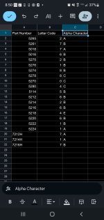

For the part numbered (1927-1941) they ran this date code system before switching to the 2 letter system. I have only ever seen the A-D after the year number.
Well every great idea seems good on paper until validated against reality. Here is a list of my "original" socket set.
As you can see by the pattern there is no pattern. I could run a statistical analysis but there appears be no correlation🤣
After digging in a bit there appears to be one E stamp as well now that has me questing my judgment. Going through my other pre 1940 date codes stuff it appears to be my only one so not sure what to think of it. Maybe it is overtime on Christmas day for legendary 5th quarter.🤣
Lastly after digging through my pre 1940 I also have a 3/8" drive socket with the date code of 30 A and that is a unicorn as well.
Any Plomb collectors have either an Los Angeles piece with E code or anything with 2 numerical followed by an alpha character?
I am at a loss @Private Lugnutz
16,614
This might be a leap year socket on the right. Most of the ones I’ve checked so far are A, B, C or D. I’ll keep looking.IMG_2364.jpeg
