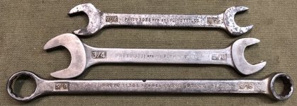

I'm up to 3...
2 DOEs and 1 DBE.

My understanding was that wrenches bearing both the Plomb and the Proto names were only made for about a year. I've only handled one, which I sold some months ago.

Alloy Artifacts says this name format began early 1948 and persisted only into early 1950, because of violating a court settlement. But then they show a couple combos like this one confidently dated 1948, without any “8” that I can see in the photos. So maybe there’s additional cause to believe it was only made this way in 1948. That would make this variation less numerous than those produced for longer stretches of time.
Here is the exact timeline: http://toolarchives.com/?q=Plomb-Company-timeline
Scroll down until you get to 11/1948.

I may be obtuse, but I still don’t see evidence to be more specific than 1948-1950? How do the court dates bear on what was rolling off the production lines? School me, please!

simply by the fact that it clearly states they shut down for to retool for the Proto changeover. One would have to assume that meant no more Plomb markings.

Note that AA dates all of their examples of dual-marked Proto-Plomb wrenches to 1948, contradicting their own summary in the Intro on page 1 saying it was used through March 1950. There is nothing about the markings on the wrenches in this period that would allow them to be dated to 1948 versus 1949 or early 1950. This is just AA being either sloppy (where it should read "1948-3/1950" in the captions) or ambiguous (where they actually meant "1948," specifically, in which case their summary on page 1 is wrong.) I think they’re wrong anyway, either way, since the re-tool to Proto-Plomb didn’t happen until over the holidays between 1948 and 1949. I think the dual Proto-Plomb wrenches are all 1949 and early 1950 wrenches. I don't see how any of them can be 1948 production. Unless I've been misreading this.
??? Now I am confused. When they shut down to re-tool in late 1948 to fix the first suit, re-opening in late January 1949, it resulted in the dual-marked Proto-Plomb dies. That was the lemonade Morris was referring to. It turned out to be poisonous lemonade. Plumb filed another suit, which resulted in Plomb having until March 1950 to remove the reference to Plomb. And your timeline reflects this, ending dual-marked tools on 2/28/1950. Or am I misreading?

I see the problem. AA uses the date that Plomb trademarked the Proto name (January 23, 1948) as the date of dual-marked Proto-Plomb production. The Time magazine and Duke University articles that underpin the TA timeline indicate that Plomb did not re-tool to the dual Proto-Plomb markings until they were threatened with a suit and a fine in December of 1948. Which took 6 weeks. Shortly thereafter, Plumb filed yet another contempt suit that gave Plomb until March 1950 to remove the Plomb marking. Again, according to the way I am reading the TA blurbs. I have not read the actual Time magazine or Duke University articles.

Yeah, I like that interpretation. They were obviously resistant to dropping “Plomb” from their brand, and attempted with the “Proto...Plomb Tool Co” to evade the intention of the ruling. Sure seems 1949 into 1950 is the necessary time period of production.

Your reduction of the timeline makes perfect sense Greg. I want to do one more check of the adverts though. Plomb did an advertising blitz in an effort to ensure everyone knew about the change.

I recently suggested a third nomenclature for these ratchet head shapes beyond the usual 'teardrop' and 'pear' descriptions as a 'racetrack' shape head, borrowed from the office furniture industry where it is a universal term for any item shaped this way.
What I am describing as "figure 8", for lack of a proper term, is the variant which has the small protrusions on the head at the half way point of the oval. You'll see both versions in the pictures of the straight oval and those with the protrusions.
RubiconJK
May 15, 2016
1,382
"I'm bad, I'm Nationwide"
I've been following the recent discussions with naming conventions and dates with fascination. There's a lot of knowledge being presented, and lots of good questions posed. It occurred to me to step back for a moment and try to envision the forest instead of the trees to see if any pattern emerges, and I believe there is, even though it's rather nebulous. I see at least four phenomena discussed concerning this time period from sometime during the war until perhaps the early 1950s:
--Use of Plomb/Plomb-Proto/Proto naming conventions on tools
--Use of WF marks
--Pebble field wrenches with strong/weak/no pebbles (more or less determined to be intentional die variations and not die wear/defects/etc
--Pear/racetrack/teardrop head ratchets of virtually the same designs bearing Plomb/Proto/Penens/Fleet/Challenger/private brands/no name markings.
I'm sure the more knowledgeable Plomb collectors could add even more anomalies to this list.
It reminds me of something some years ago in the computer business with the mfr PCChips. One fellow who set up a website for folks to help figure out what's what called it the PCChips Lottery. I feel a similar way with all this, and to echo that sentiment I'd call it the Plomb Empire Lottery. Every time you try to draw the numbers, they all look different. Truly a moving target.
Having been involved in corporation management, I sometimes try to see things from that perspective. What I see when looking at all this evidence is a company in a state of flux and perhaps even internal confusion. A company that was doing lots of business but in almost a chaotic manner with no clear path and direction toward the future. Too busy making today's meals to even figure out what was going to be on tomorrow's menu. I also see a lot of evidence of upper management delegating important decisions to lower management in various departments, further muddying the waters. Much of it seems to be shooting from the hip, perhaps making major changes at each production run of an item, trying to feel its way in the dark, probing here, testing there in an effort to reconcile everything into a clear and concise production model having the greatest, most sustainable benefits. There also may have been some lower management shuffling so that at each production run, key decisions were being made by whomever was in charge at that moment, each run seeing a different supervisor.
Stuff flows downhill as we all know--I think the reason why it can be so confusing for us down at the bottom of the hill is because of the apparent confusion at the top. I believe the evidence shows that, for at least a handful of years, these boys and girls were flying by the seat of their pants. In the greater picture, the Plomb/Plumb lawsuit seems only to be but a single act in a larger three-ring circus.
Now, some of the phenomena can be reckoned with outside-looking-in external reasoning. But it's also clear that some phenomena are the result of internal reasoning, which on the surface is counter-intuitive because we're not privy to the internal dynamics at play. And from the evidence there seems to have been a good portion of that. I've seen instances where over-presumptuous sales teams have sold customers on an item that did not yet exist, then hands the specs to the engineering/production team with "Here's what we sold, and for this much--make it" with no thought as to what might be involved. I've seen other corporate instances where sales, engineering and production departments had such poor communication that one hand really didn't know what the other was doing. I've seen mfg production to where one standard was on paper, but the actual product was made according to the 'tribal knowledge' of those working out on the production floor who made it however they saw fit regardless to the 'official' specs. We also have the added factor of temporary women workers during the war, some in key positions making critical decisions about which they had little practical experience, then all disappearing after the war to have their places taken by new people. I see the evidence of these kind of internal dynamics in the artifacts we have from that time period. However, unlike some other companies, Plomb appears to have been very prolific during that time, and so we have many, many artifacts over which to scratch our heads.
Unless we were able to actually speak with the individuals working in the company at the time (and by the questions we'd asked, that would be more than just a few persons), we'll probably never know some of the answers. They've been lost in time. Lucky for us! For the Plomb Empire Lottery will continue to provide us with fascinating and lively discussion (fun!) as historically-minded folks persistently ply their puzzle-solving chops on this huge menagerie of artifacts.
IMHO the variants are probably as much due to normal product evolution over many, many years of production and heavy sub-contracting for capacity. As I have found when trying to order a replacement part for any recently made electrical appliance, there are industries out there where product variances are even more prevalent and troublesome! Lol!
