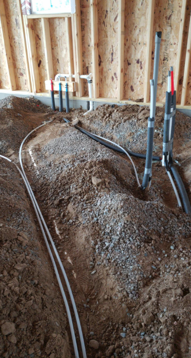

We run pex underground all the time also, but only inside the house. Cant comment on outside the walls, we don't touch anything there but I imagine it'll freeze quickly if you're in a cooler climate. I'm just the FNG tho, maybe someone else will have more info :D
not sure what the code is in your area but down here we would sleeve the pex inside of black poly pipe for a few reasons.
1- if you have an underground leak without a sleeve you will never know it is leaking.
2- it seems as though you provide a sleeve where the pex protrudes through the slab. which is good to prevent the concrete from eating away at the pex but as your picture shows the surrounding dirt is full of rocks which can rub on the pex as it can vibrate with the water running thru it
3- sometimes you can slide out the leaking pipe from the sleeve and slide a new pipe right in the existing sleeve
4- pex is more forgiving if frozen where as something like copper will freeze and burst from expansion

Here they don't require it, but were using 2013 UPC.
Yah the rock is code here, gotta have 4 inches of rock ontop of the dirt and then its polyd over, suppose to be for radon gas I guess...
It's also backfilled -> Dirt -> Rock, so while the issue of rubbing is probably there, it should be buried mostly in dirt. We do sleeve the hots for energy savings they say tho haha.

That stuff might be too thin for underground; I don't know for sure.
I wan't to replace the underground 3/4" branches before they go into the house.
I'd use PEX. The pipe is freeze proof - the fittings not so much.
I replaced an underground, leaking 1 1/2 PVC pipe with dual, 1 inch PEX about 10 years ago. It's a longer than 120 foot run. Has been working with no problems.
I used dual 1 inch lines to give me about the same cross section as the old PVC pipe. (1.57 versus 1.77 based on the nominal size) I could get 1 inch Shark Bite fittings for 1 inch PEX but not larger. The tools to expand and secure larger PEX would have run more $2K, so 1 inch PEX with Shark Bites was a lot cheaper. Though these days, I use copper crimp rings.
I have upwards of 400 feet of buried 1 inch PEX around my house. The only problem was that one brass fitting dissolved and started leaking!!
The flow restriction with a few fittings isn't much and I've never noticed it. Since you normally run single lengths of PEX, the only fittings are on the ends.
PEX is pretty tough. Just try wrestling with it when the temperature is in the mid 30's
