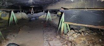

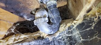

This all started March 6th. Some background... Doublewide Mobile home my girlfriend bought in 1987 in the Colorado River town of Bullhead City, Az. Over the years its been severely abused and neglected by family members she let stay there while she was living in SoCal. This was supposed to be the retirement home. Rainstorm was headed in when pics were taken, that why the ground is wet, its not a leak
After using the drain bladder, as stated above, I thought the problem had finally been solved, that was 4 days ago. The following morning, once again the master toilet wouldn't flush correctly. It would flush, but the toilet bowl wouldn't fill up with fresh water, trying to flush it again would then overflow the toilet. Plunging the toilet would push the water up through the shower drain. At that point the only thing I could do was either vacuum up the water with a shop vac or wait for it to drain overnight. The sewer mainline cleanouts, 3, were all dry, unlike the first few times when they would top off. I finally broke and started calling plumbers. This is the desert, lots of people but not a lot of services, I called 4 out of the 5 plumbers, 1 said he couldn't come out till Thursday, the last guy actually answered. I described the problem and first thing he said was, "Have you had any street work done lately?" In fact, we had. The city and a fiber optic internet provider had recently installed fiber optic cables, new curbs and re-paved the road. "Call the city, they bored thru your sewer main, I had a guy on Ramar Rd that called me yesterday, we're working on it right now". ****, we live on Ramar.
Made the call to the city Wastewater Department and within an hour had a guy in front of the house checking the sewer. He tells me there is no flow and a pump truck is on the way to pump out our mainline. But the mainlines are dry, this baffles them too, so they send out a dude with a camera snake. This is where it gets interesting. 3 City crews in less than 2 hours, I was impressed, anyway, running the camera down the 2 cleanouts on the South side of the house, he spots a problem 16 feet in. It looks like the pipe has or is collapsing, then at 96 feet he hits a clog. Now, I had assumed the mainline ran East of the cleanouts about 7 feet, then made a left at the corner of the East end of the house, continuing North to the street. In order to find out where exactly the possible break is he grabs a wand that picks up the head of the camera while its in the pipe. That line is going in a complete different direction, it goes South 20feet, makes a right, continues West about 40 feet, then right, going North up the middle of the West side of the house to the street. At 96 feet we find the clog. The clog is a third cleanout that we thought was a cleanout for the septic tank that was put out of service years ago. The cleanout was level with the dirt, had no cap and was filled with rocks and dirt. Great, problem solved. Cleaned out the rocks, grabbed the hose bladder, size small and run it down the 4 inch pipe. This cleanout is a branch that leads under the house, runs almost the length of the mobile to a 90 degree elbow and ties in with the rear bathroom...I think. City guy isn't really sure either. City dude gets a call and has to split, but says he'll get a diagram and come back the next day.
Running the hose with the small bladder down the 4 inch cleanout, I get about 15-20 feet and hear the sound of a balloon popping coming from the same cleanout I'm working on, hmmm. To be continued....

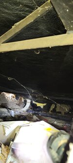

Day 13
I don't like not being able to fix something, it pisses me off. I start coming up with ridiculous theories as to why the problem can't be solved, so if I start saying stupid ****, bare with me, I'm just frustrated. After waiting for the water level to go down yesterday, I ran the medium sized bladder down and let it sit. The guys from the city said they use them successfully all the time, they also told me to let it sit for hours, even overnight if I have to and so that was my intent. After an hour, I became impatient and started messin with it. Release the pressure, move it around, pressurize it, rinse, lather, repeat. I don't know WTF happened but suddenly the level came roaring to the top and over, I didn't even have time to yell to my assistant to turn off the hose, all I could do was to dance around and crimp the hose. After another hour of waiting for the level to drop so I could pressurize the hose again comfortably, without much luck, I said, "**** it, let it sit overnight" and shut down. As of 5:45am, it appears the level dropped about a foot, much slower than usual, but at least its still draining...a little.
Todays plan of attack, change the medium bladder to the small bladder, run it till I hit the clog, park it and walk away for a few hours. I started digging yesterday in the spot where the camera showed the pipe possibly collapsing. I had marked the area with yellow spray paint, had dug down about a foot and half, maybe two when I struck what sounded like something hard and was black. At first I thought I had found the pipe, nope. As you can see in the pics we've got rocks. I swear, Bullhead City is not natural desert landscape. The first time I saw the area I thought it was man made. The "hilly terrain" looks like the Gods...or man, made piles of dirt everywhere. The more I think about it and look around, the more I'm convinced that Bullhead City was built using all the rock and dirt from Hoover and Davis Dams, trucked in and dumped in neat piles. That said, our whole "yard" consists of dirt and a zillion rocks, some, most are small, but others are simply boulders. That black pipe i thought I struck turns out to be a massive black boulder sitting atop the very spot the camera showed the break. I haven't dug it up yet but I'd say its easily 2 feet across. I'm afraid that if I dig it up its going to create a bigger problem, yet I know it has to eventually come out . Annnd here is where my logic becomes fuzzy. I'm certainly no Engineer but I would think there could be some "suckage" involved in the fluid stream, in other words, a pressure that pulls the fluid created by pressure build up in the pipe, assisting the flow. If there's a break in the pipe, allowing air in, reducing the pressure, therefore restricting the flow? Is that possible? My other "theory" is that there is a massive clog at the elbow under the mobile that leads to the rear bathroom drain. Its at about the right footage related to where the hose stops.
Any Plumbers in the house? I'm 'bout at my wits end, so any and all comments, suggestions, theory's, etc. are welcome, just let 'em flow...(pun intended). Time to go to work.

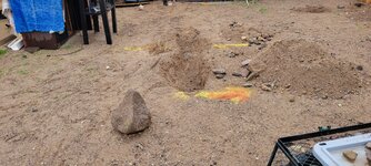

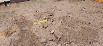

Started digging out the "massive black rock" which turned out to be a big *** chunk of asphalt, almost 5 inches thick and a brick. Seems to me if the pipe was broken, the dirt would be wet. So far, no pipe and no wet dirt.20230319_114539[1].jpg20230319_114523[1].jpg20230318_223658[1].jpg

On the map, it shows locations for "new" cleanouts, those do not exist, just the 2 under a patio cover that no longer exists and 1 at the opposite side of the mobile.
I started to run the hose down the toilet drain again and got nowhere, literally. The hose which worked fine yesterday has decided to take today off and just kinks and folds, I cant get it into the elbow, so now I'm off to see a man about a hose. I was able to get it down the cleanout on the side of the house which accomplished nothing. It didn't back up, the toilet drain or shower didn't back up. I'm at a loss and becoming extremely frustrated. :headscrat :dunno: 😡

You could put a clean out elbow in place under the house on the corner to the east main line. Then you could at least clear under the house and look at what going on inside. Then it Looks like a straight shot out to the old septic tank and the supposed disconnect. I wonder if they did it right in 2006 seeing some of the history of the place. Putting in a clean out near the corner at the old tank would be next.
Wow. Ok, so now I understand how this sewer run goes, and why. It’s not ideal with all of those corners in it.
Can you rent a plumbing camera? Or get a sewer rodding company to come out with one? Pull the furthest toilet off, and go down it from there. I expect you’ll find something at the junction where they cut off the septic and turned left, marked “new c/o” in red at the back of the patio.
The **** you dug up is interesting. Rocks happen, but somebody put that chunk of asphalt there.
A partial collapse may not make the ground wet. The water and solids mostly flow along the bottom of the pipe. So a hole in the top may not seem like much from the outside. It does allow dirt and debris in to the pipe, which can plug it up.
You’re in desert, relatively warm climate, no frost line to worry about, and it looks like maybe this isn’t very deep? Here I have a basement, so the sewer starts around 10’ down and drops from there. Maybe dig down to where the sewer was attached to the old septic run. Replace that corner 90 with two 45 s for better flow, if that’s where the plug is.

Day's 15, 16, 17 & 18
Bought the biggest bladder HD had, couldn't get it past the first elbow, so I replaced the medium one that popped, still no luck. I sacrificed my big wet/dry vac and started using it to vacuum out the drainline every time it would back up from using the bladder. Tuesday and Wednesday we had heavy rain that came in from California, which slowed efforts a little. I did get up on the roof again to check out the vents. I have strong magnets but no way to attach them to a line.
While using the medium bladder, I got it to the clog and marked the hose with electrical tape, pulled it out and measured the length. The hose had gone 34', I then measure it out from the edge of the house, following the direction of the pipe, which took me to where the elbow is. My theory is correct, the clog is at the 90 degree elbow, UNDER the house. My girlfriends brother came back out and we've decided HE will crawl under, cut the elbow out and replace it with 2 45degree elbows.
Last year, I completely re-modeled the front bathroom, replacing the sink, toilet and tearing out the bathtub and put in a large shower. Having never had done this before, I screwed up and failed to hook up the shower drain to the sewer line before installing the shower, 20230324_093410[1].jpgwhich left the shower unusable. The shower is a foot away from the East cleanouts and above the elbow that will be replaced, so in order to avoid having to crawl from the East access port to the work area, I got out the shovel and dug out a tunnel under the house.
Today we cut, replace and hook up drain lines
