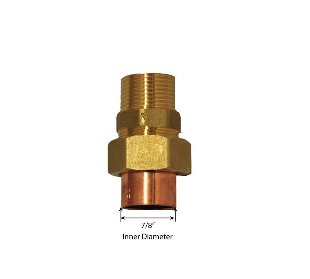

Hello, I am putting in a pre filter on a 3/4" copper line and would like to use unions for a few reasons. One to prevent heat into the plastic filter housing and 2 to allow for easy removal for whatever reason. The housing is a 1" MIP but I'm having issues finding a 3/4" copper pipe to 1" MIP union. Do they make these? I suppose I could just go w/ a 3/4" Copper to copper union but then I still need a $9 3/4" copper to 1" MIP fitting (I do have these but the less fittings I have to use the better) Something like this is what I'm looking for but in 1" MIP?
Do most just go w/ a male coupler and a 3/4" copper pipe to 1" FIP fitting? I know I could cut it out if I ever need to but I'd rather make my life (or the future owners lives) easier down the road. If you have other suggestions I'm all ears.

Yeah I was hoping to do it w/ one fitting but it doesn't seem likely. I already had purchased the 1" MIP to 3/4" C fittings, I'll just get 3/4" C unions. I was hoping to get an all in one solution (1" MIP to 3/4" C union) bu not seeing much in that respect.

Thanks guys went with unions and all is well. Not too ugly. Oddly both freaking unions leak. Nothing else I did leaks but the machine made unions drip. Surfaces look good and I cannot tighten these things anymore if i wanted to. It's a VERY slow drip so I'm going to let it go for a day and see how she goes.

You can Scotchbrite the mating surfaces up a bit first and I put a dab of pipe dope on the threads, just lets them slip a bit and tighten.

Good call. if this common on these? I figured they'd seal better than my rookie soldering. Only my second time doing it. MAP gas is SOOO much nicer than the propane I was using before. No wonder it was so difficult the first time.

A set of the di-electric couplings that are used on water heaters would keep the heat out better as there is no metal to metal contact between the halves. Some lubrication does make the joints tighten better.

A little dab of RectorSeal #5 works wonders. I always put a thin coat on angle stops (compression).

Unions these days, especially copper ones, I just break out pipe wrenches that look way to big for the job. So far I've gotten them all to seal. Using lube on the threads is good in order to transfer more of the torque to clampload before giving up to friction within the threads.
