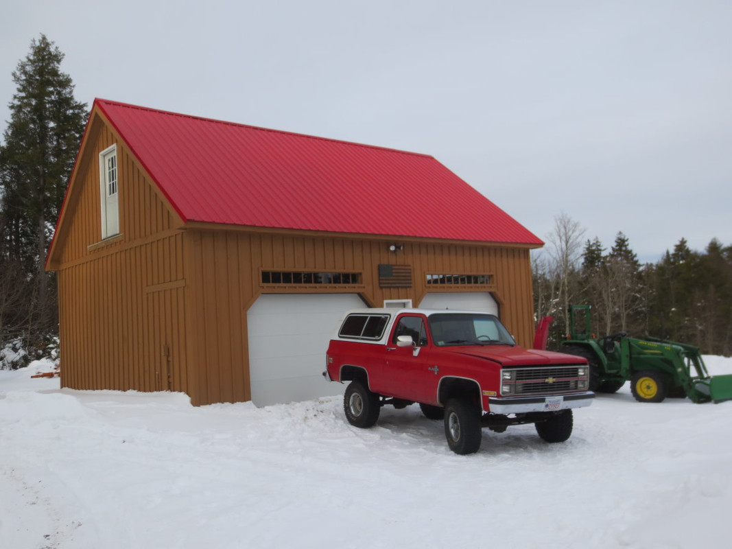

...if you go that route, stain the siding with a good qaulity stain; do not paint it.
stain gets into the wood, never flakes; it may dull over time,...
...used rough-sawn siding (no grooves) and batten boards on our house, Olympic stain ...re-stained twice in 45 years....so about every 15 years.

Why not just do board and batten then? This is my 25x35x12 with 1x10 pine board and batten for reference. My poles were about 8' OC and I had 2x4's girts (or nailers) every 2' OC. Stain it the exact color of your house.
